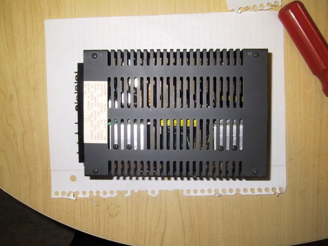

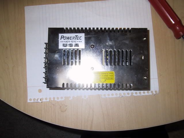

So, I started to switch out the power supply.. I need a little help in getting the wires right. I'm getting rid of this:
And Putting in this:
Some of of the amps and symbols seem a little different:
So far, I have come up with this:
Wire Color: | Current PS | New PS
Brown/White | +12V 1A | +12V 3A
Blue/light blue | -5V 1A | -5V 1A
Grey/White | GND | Wierd Symbol? (Is that ground?)
Red, Red/Pink | +5V 7A | +5V 15A
Blue/Yellow | AC | AC/N
Yellow/Brown | AC | AC/L

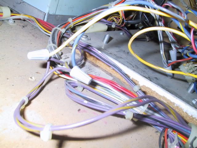

Now, there are also some hacked wires inside the cabinet:
From what I can tell, the colors correspond as so:
Williams Harness ---------- Wire to PS
Purple/Yellow = Yellow/Brown
Purple/Yellow = Blue/ Yellow
Gray/Yellow, Gray/ White = Brown White
Gray x2 = Red
Gray x2 = Red/Pink
Orange, Grey/Green = Blue/Light Blue
Black (A Lot) = Grey White
So.... in other words... I need A LOT of help. And a quick dumb question: what does the knob do at the top of the power supply? I'm pretty sure it changes the voltage in some way, but I'm not 100%... I just really don't want to fry my beautiful new Robotron Cocktail..

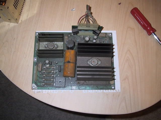

Also, I do have a very nasty old Williams PS from a Defender Cocktail.. i don't think it will fit in this game.. and I bet money that its completely dead.
From those pics, most of the wiring I need for a template is there. Show me more pics of the wiring. [email protected]
I have the power supply that you need, and you have the big ass heat sink that goes with it.
Shoot me a pm and we can talk about getting you all back to original if you want.
