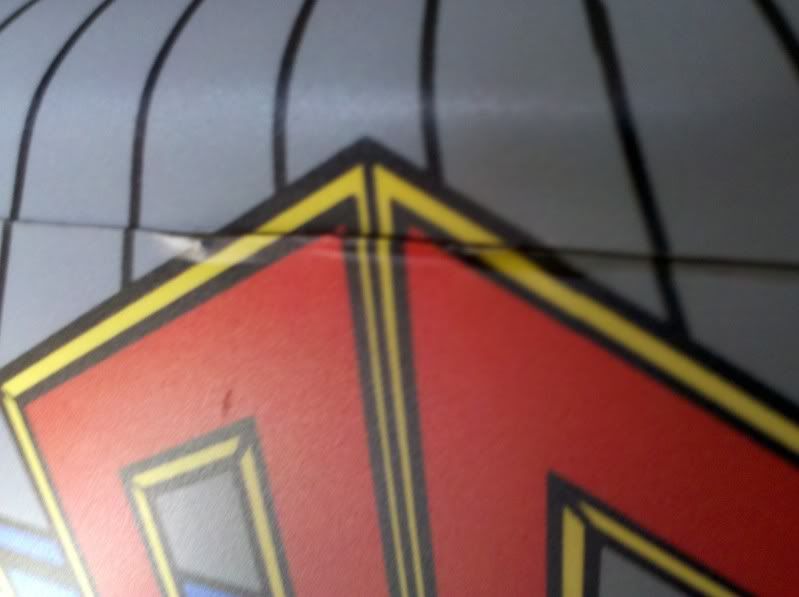

It's hard to tell from that picture.
Are the outlines thin and crisp like this original?
or fat like the repro image below?
