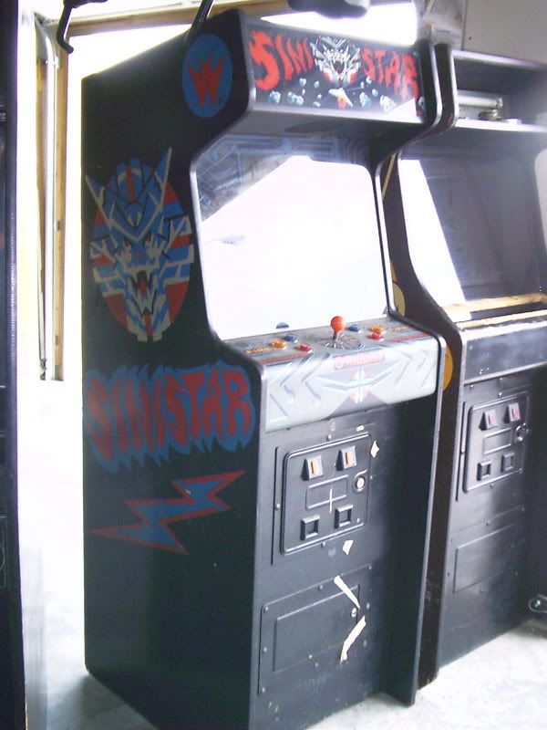

Funny, my Sinistar was narrow like Moon Patrol but had the straight sides like Robotron:
Stargate, Joust, Joust 2 and Robotron had 24-1/2" control panels. I think MakeTrax is this same size, but I can't get to one to measure it right now.
Bubbles, Moon Patrol and Sinistar (and I think Blaster) had 22-7/8" control panels.
Because the control panels, bezels and marquees were all the same size, each of the cabinets were interchangeable within those 2 groups (except Sinistar and Joust 2). As previously mentioned, when an order came in, if they were out of a specific cabinet, they would use whatever was handy from the same size group.
That is why I have a Robotron shaped cabinet that has Stargate paint under the black and a Joust with Robotron stenciling under the Joust art.
Sinistar and Joust 2 were vertical monitors so they were oddballs and were difficult to convert.
Mixed cabinet/paint on Williams cabinets was uncommon, but hardly rare.
