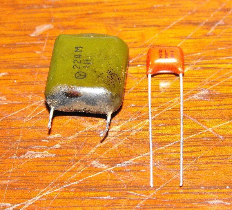

Just curious... had to order blindly and I thought I picked the right type for what I needed... I just want to make sure before I plug them in and apply power.
Old cap on the left, new cap on the right... both .22uF. I notice the picture looks like the right one says 225 or 226, it's actually 224, just doesn't look good in the picture.
Both of those look like film caps....Do you know the voltage ratings of them? Judging by size, cap on the left looks to be a higher voltage rating than the cap on the right......but, now-a-days, with micro-mini caps to hard to tell by looks.

Yeah, both are 50V.
