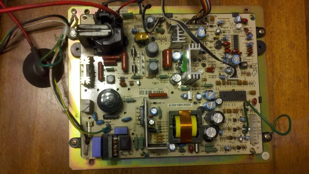

Problem - Vertical hold is unstable, picture jumps from steady to a hor. line and back
Capped monitor to regain color and brightness, picture was just dull and dark. Had no problems prior to capping. Used a BR kit. All was good, so I thought. It brought back the colors and contrast in the picture, but within a minute of running the vertical hold starting falling off, flickering, then to the point of dropping to a horizontal line in the center of the monitor. By adjusting the V-HOLD u can make the picture come back, but it will just fall back to a hor line. I've read about some of the usual culprits, like IC3, but it will display fine and then jump out of hold to that band or roll so I'm not confident those things are the problem. Any help is much appreciated.

I reflowed the v-hold pot but there was no change. I did not hit the vertical ic nor the yoke. I'll give those a try when I get home from work. I'd guess the yoke solder would be more likely since i had to remove that part from the tube versus the IC. I don't know which chip is the IC; the chassis diagram on WG site blows. Pic below if anyone could point it out.

Well I'm close. I had some success resoldering things, but the problem is still there, just much less frequent, and typically just looses sync, not going into full v-collapse.
I addressed the yoke plug by reflowing all of the leads and redoing the solder on the vert yellow wire pin
Checked IC302 leads; looked fine
re-soldered a bunch of the caps that had dull looking solder (I really couldn't see anything that was clearly bad), focused on ones in the vertical sync path according to the schematic on randyfromm; pulled the old solder this time
I replaced a cap that was missing in the kit with one I had pulled and checked out
Since the problem changed I know I hit upon it in one of the above steps. I think I made a cardinal sin and screwed myself by not removing the old solder when i did the cap kit...i just heated, pulled and dropped the new in, with a little fresh solder. This time i replaced the old solder completely on the ones I rehit.
Looks like I'll be re-doing every cap i put in...fml. getting sick of going through the fear factor test of discharging the tube
check the solder on the header pins where the video input connector plugs in. ALso check width coil(if it has one) etc.. you are readjusting the holds after reinstalling correct?
Yep, playing w the v-hold, size, etc. .. i have been brave and stuck my hand in there to wiggle all the plugs to the chassis and neck board, including the video input plug, and saw no change.

id definately replace the old caps, could be part of your issue and just do em to eliminate them as a suspect...
the fact that it gets better over time, after fiddling around screams solder joint to me, could be something else too but next time it gets bad enough to drive you nuts check over very solder joint man. Itll take time but you may just find the culprit. If this has a heatsunk mounted ic to drive the vertical video thats something is really be checking for cold solder joints..
