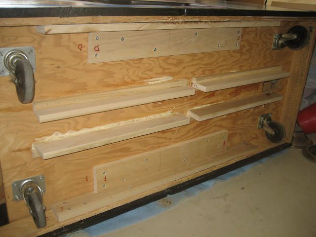

After it was clean, I went over it with an orbital sander to get the stubborn dirt, grime, and top layer of wood. Then, I flipped the machine on its side to remove the base plate. Since my base plate had some swelling in one corner, and was filthy, I decided to build a new one. So, to remove this one more easily, I used a circular saw to cut from wheel to wheel on either side of the center channel. This allowed me to pry out the middle channel w/o putting too much strain on the sides since the base plate. Once the center channel was removed, I went back and pulled out the staples around the perimeter with a pair of needle nose pliers. To do this, I drilled a small hole on either side of the staple for the needle nose pliers to fit in. Finally, I was able to remove the remaining two sides of the base plate, by prying from the insides.
I traced the original base plate onto a new 3/4" sheet of birch plywood and used a saw board to cut it to the proper size. Next, I traced the wheel holes. I free-handed them with a jigsaw, which worked out pretty well, except for the first one, which ended up being a bit more of an oval than a circle...but this will be under the machine and the only people that know are who are reading this post. :)
I cut replacement pieces to create a new channel down the base plate's center. This time, the channel pieces were glued and stapled to the cabinet bottom instead of the new base plate. I also left a gap for the big cut. I also cut wood pieces to screw into the wood on the sides and the underside of the cabinet for reinforcing the cut I was about to make. I made sure to label all the joints so I had no issue putting it back together. I removed all of the top half reinforcement pieces and used a hand saw to cut between the two pieces on one side of the cabinet. I cut deep enough into the floor so I could screw in the side support I had made. Next, I used a jigsaw to cut across the floor. As I cut along, I would stop to install the reinforcing pieces I had made once I cut past where they would go. When I got close to the other side, I needed to flip the cabinet so the remaining uncut side was on top. By cutting the cabinet like this, it is almost impossible to tell it has been cut once reassembled and the floor is covered with new replacement matting.

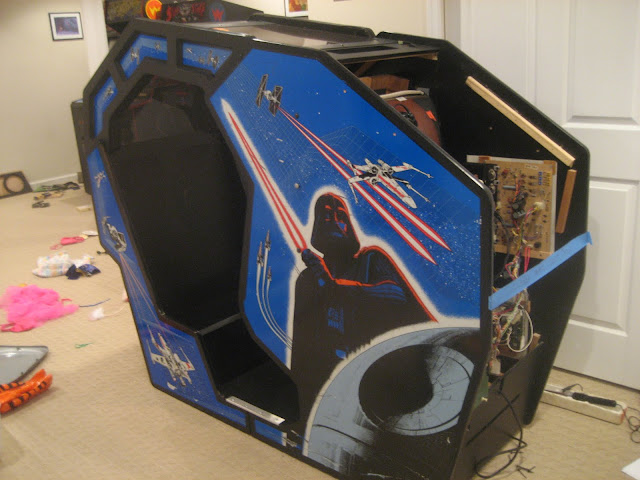

Since it was cut in two, it was possible to move it into the basement (which has a 90 deg bend on the way down the stairs). Once it was moved down there, I was able to reconnect the two halves, and start loading it up. I installed what I think is a Star Wars upright harness using pictures I had downloaded online to help as a guide. I needed to create the section of harness that runs to the second set of speakers.
With the harness, power brick, game pcbs & cage installed, I started to put together the monitor. I got a 25" medium resolution raster tube and 6100 yoke in a trade with danthepup. After reading as much documentation I could find online, here is the process I used. I carefully marked the location of the convergence rings on the tube neck and also drew a line down the complete ring assembly so I could put them back on in exactly the same place and orientation. I carefully cut through the glue holding the rings in place and slid them off. I swapped the 6100 yoke in place of the raster yoke. In order to reach the amplifone deflection pcb, I needed to extend the yoke, DAG, and degaussing coil wires. Next, I replaced the convergence ring assembly in the same location as it was before, connected everything up and...nothing. The game was playing blind, but I there was nothing on the screen. The spot killer was off and I could hear deflection chatter, but no neck glow....so I knew I was close. After checking HV @ the tube, B+, and everything else I could think of, I found the problem. It turns out that when I had taken apart the tube connector to clean the pins, I did not get one of the heater pins back in place properly, so it was not making connection with the tube connector. I quickly fixed that, reassembled the tube connector, plugged everything back in and voila, Star Wars was playing in this cabinet for the first time in over 12 years. At least that is what I think based on thread that I found on rgvac usenet group about a Star Wars cockpit converted to a Great 1000 Mile Rally:

By replacing the convergence rings in exactly the same spot and orientation as they were before, you can see that convergence is pretty good in the center. I do have some work to do in the edges and corners. You can see this in the PULL TRIGGER TO START message.
