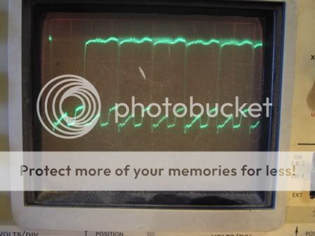

I've tracked and repaired a couple more issues causing bad logic on the data bus and the rug test is looking much better (but not perfect), but now here's the interesting part....
At boot up I get the ram error code 1-1-1. But I know the ram, and socket there are good and signals on all pins look ok. (Any one have signal diagrams from a good system?) If I pull a ram chip from any where in bank 1 or 3, the error code corresponds to the correct ram position I just pulled. ie 1-1-6, 1-1-8, 1-3-5. However if I pull a ram chip from any where in bank 2, the returned error is always 1-1-4. Any chip pulled in bank 2 reports an error in bank 1 socket 4 ??? Surely some thing odd going on in address decoding.

I've got a couple of photos to share, one each of a typicall ram data out and data in on my board. You'll have to excuse my old/slow scope. It tends to round off and attenuate faster signals and some times it's hard to sync in a good spot causing over lapping pulses. Even so, do these look any thing like a working board. The input signal looks more like an analog signal than digital to me. You can see these patterns pulse and change as the initial rug test runs.
Typical DRAM input signal at pin 2
Typical DRAM output signal at pin 14
Plaz
