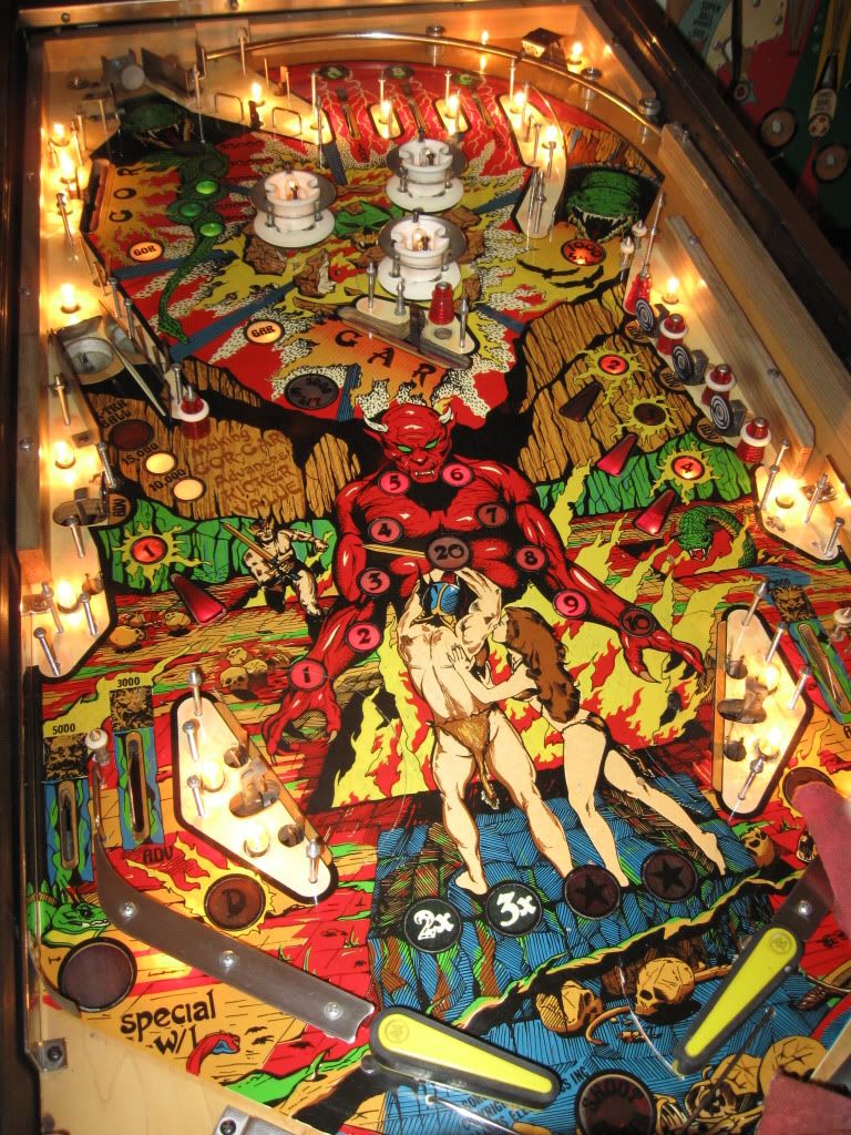

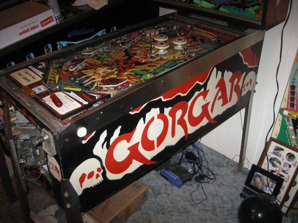

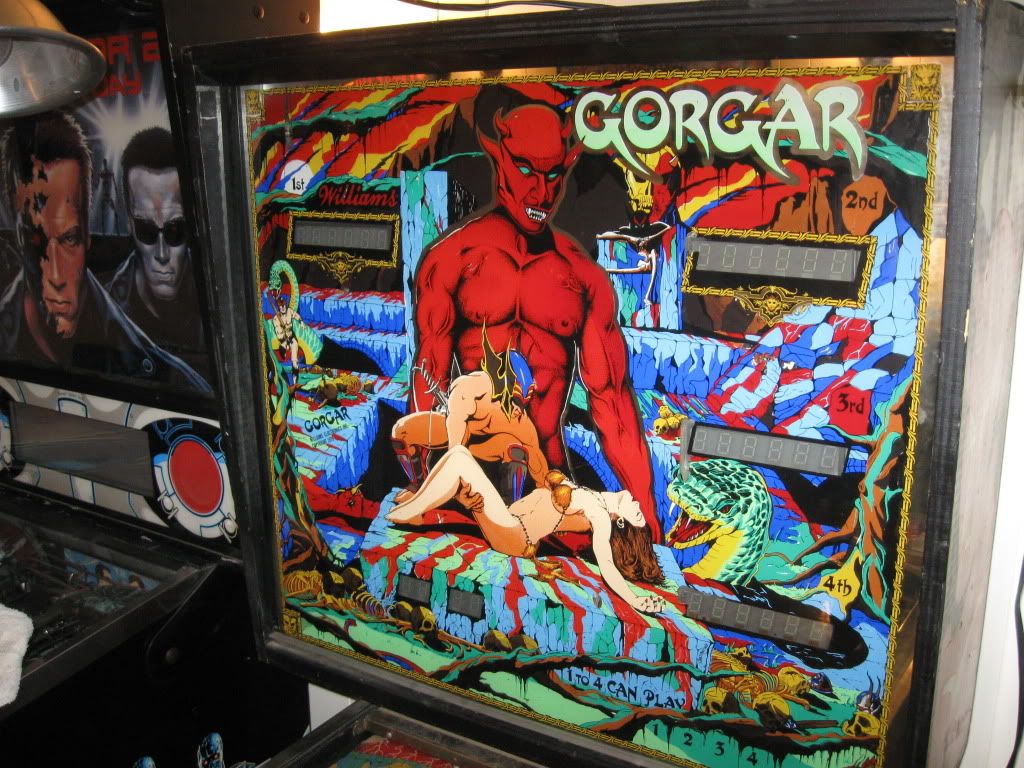

Finally decided to start getting my Gorgar cleaned up and working 100%.
Here are a few shots of the before...
Overall the game is in pretty nice shape. A few inserts have a little wear. Some post holes are pretty blown out. Backglass has a few decent size scratches on it. But the game works for the most part. Has a few board issues, but Ill tackle that later.

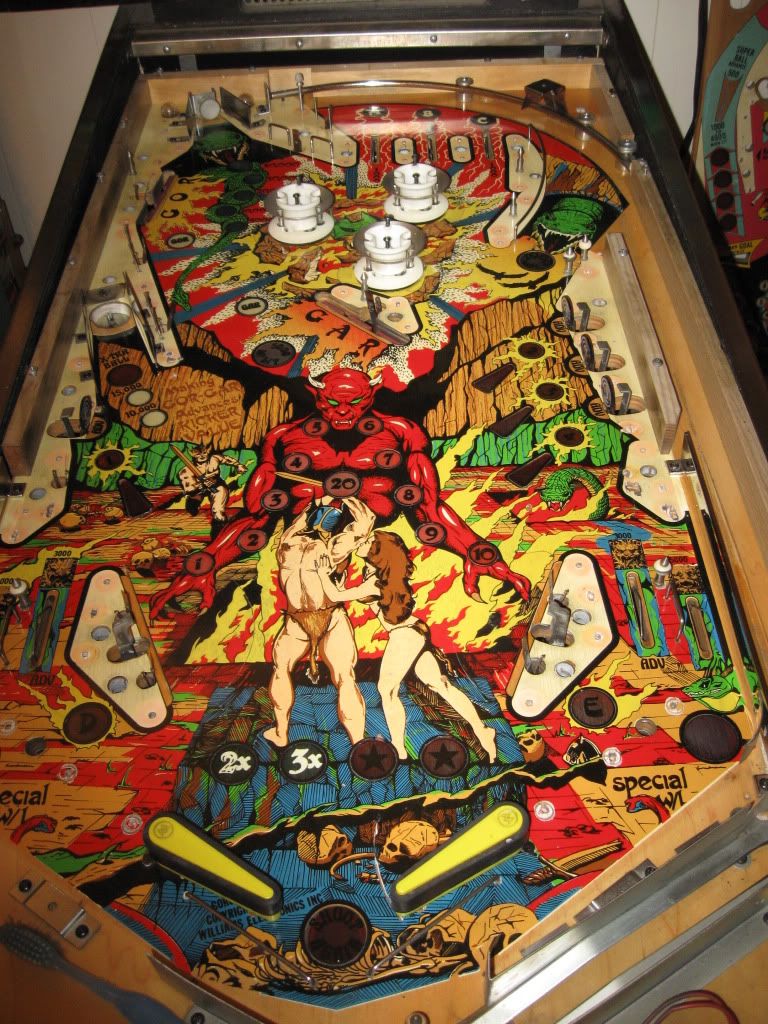

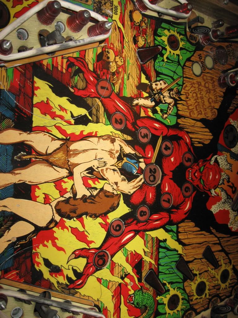

Removed all plastics (quick run through the dishwasher and they clean up like new), removed all posts and lamps and touched up the inserts...

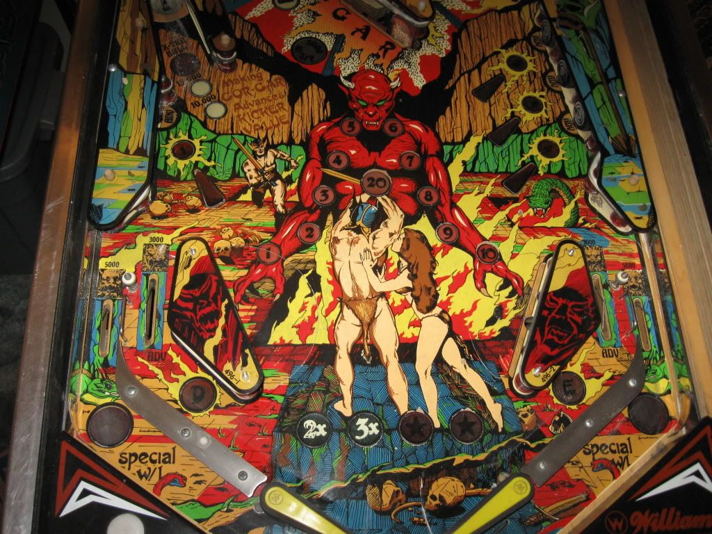

Flipper tune ups and changing lamps under the playfield...

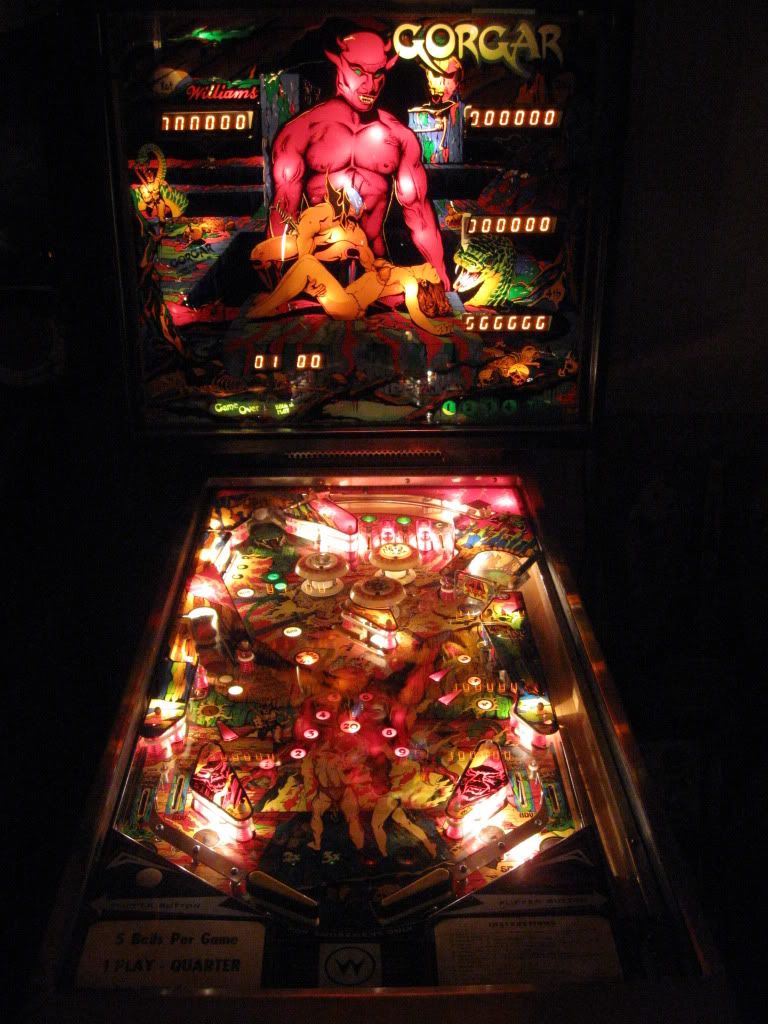

Cleaned and waxed and relamped (thinking of doing LEDs. Maybe a Red and Green theme)...

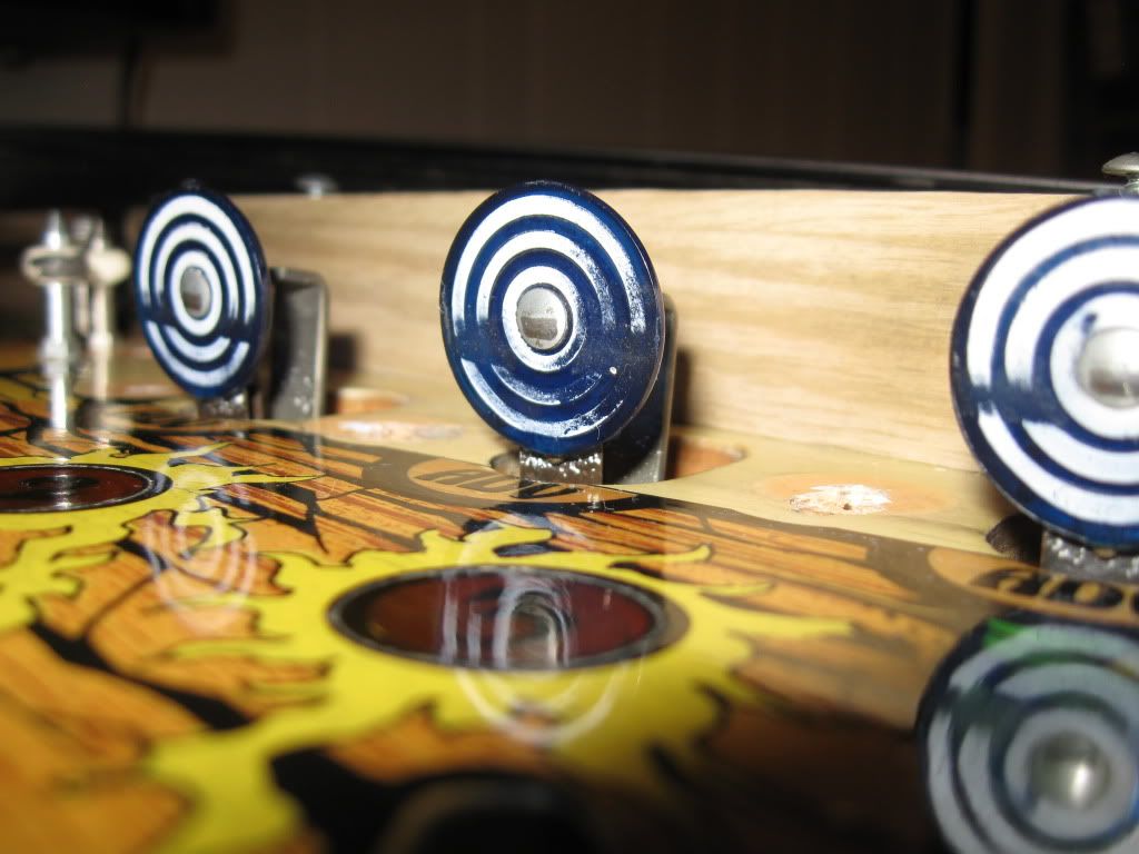

Nice shine...will prob replace or try to repaint the blue targets...
Still have some board issues to take care of (not holding memory, and game will just shut down after awhile).
Would also like to remove, patch and repaint the front of the cabinet where the 3 lag bolts are.
Speaker upgrade me be in the future as well.
thats one of the nicest looking gorgars I've seen in a while. As for your board issues Check your 5v might be low or dropping out forcing the reset (possible 5v filter cap) as for the not holding memory check the battery holder closely might have a bit of battery damage hidden.
