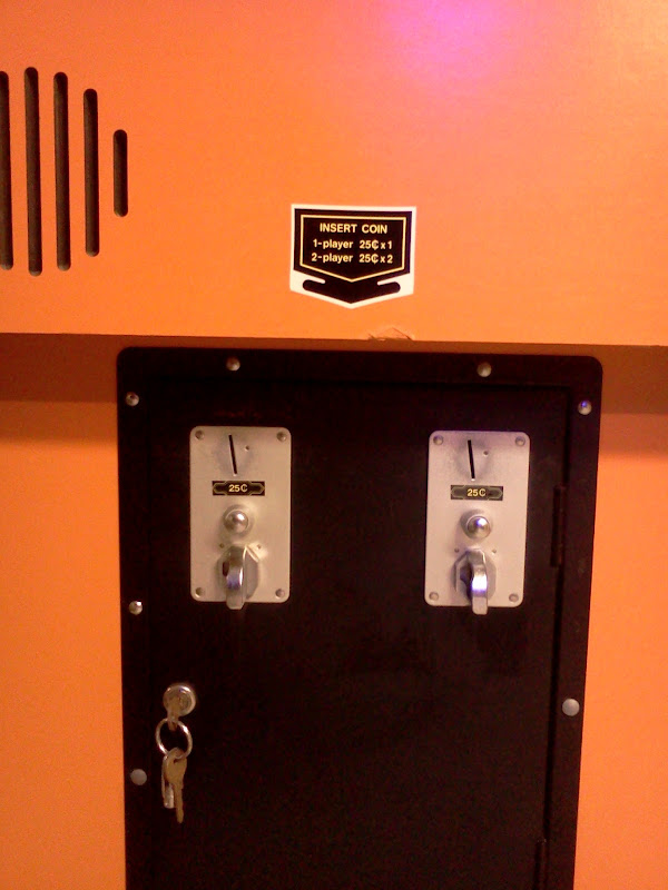

I picked this up in April for free, as you can see this will be pretty easy to restore:
I figured all I needed to do was install a cap kit as the monitor is a little narrow and apply the side art I picked up. Then I noticed these extra carriage bolts:
So the operator must have installed these to make the bezel more secure. After taking the bolts out the lower ones will be covered by the side art:
Lower Left bolt:
Upper left bolt:
If I move the artwork to the right about a 1/4 inch the upper bolt hole should be covered too.
Right side lower bolt:
Right side upper bolt:
Here is the side art positioned to cover the upper bolt too:
And, I have the monitor out and discarged ready to be capped. I left paper bezel on as I don't want to replace it and it is in great shape.

Oh those bolts serve no function other than to stop people from pushing the bezel into the cabinet. The bolts are going, and I have color matched oil based enamel that I will touch up the holes after I fill them in with bondo. It depends on how the touch up looks, I might move the art to cover, or just keep it in the original position.

It really did come out great. I feel like it was the easiest restore I have ever done. You can't even see the one hole on the right side that I filled and painted. That color matched oil based enamel is great. I ended up painting only an area the size of a dime for each hole, and only one was not covered by the new side art.
