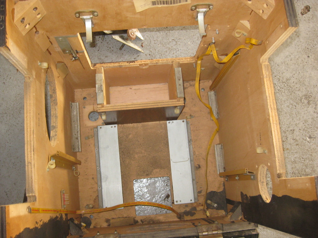

Coin door and table top removed
Most of the rest of the wiring out, and suitcase iso brick removed.

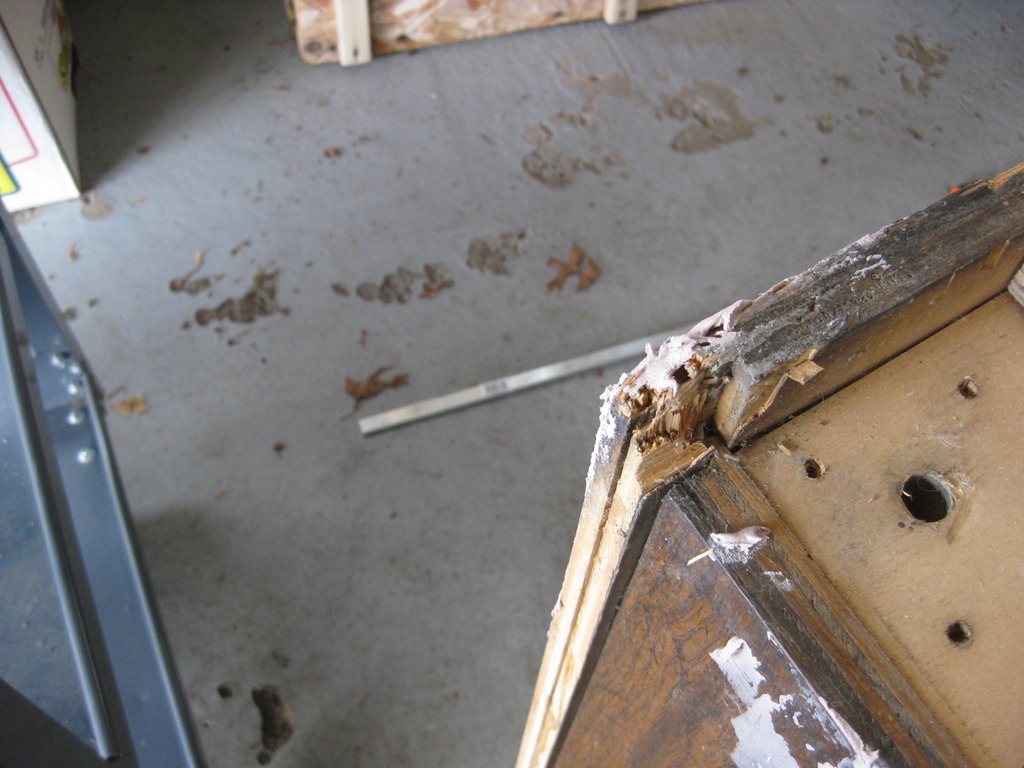

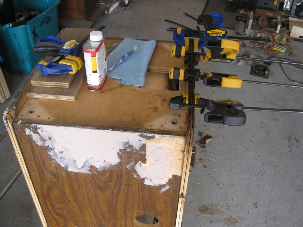

Starting bondo. Lots of chewed up edges here - I will have to re-apply woodgrain overlays. Also using wood hardener on one edge that was splitting pretty badly. I'll glue and bondo that edge next.
Starting rebuilding corners. This one is the worst.

Bondo work is progressing along. It's always slower than you want it to be. I'm going to have to reform all 4 corners which will be a pain. I had to move the cab inside to my basement to continue the work, since the weather has taken a turn for the worse up here in WI and it's no longer 55° in February any more. :(

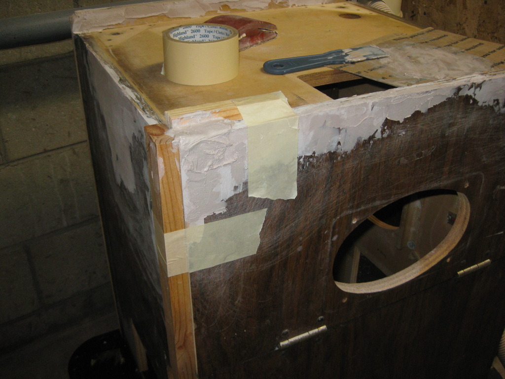

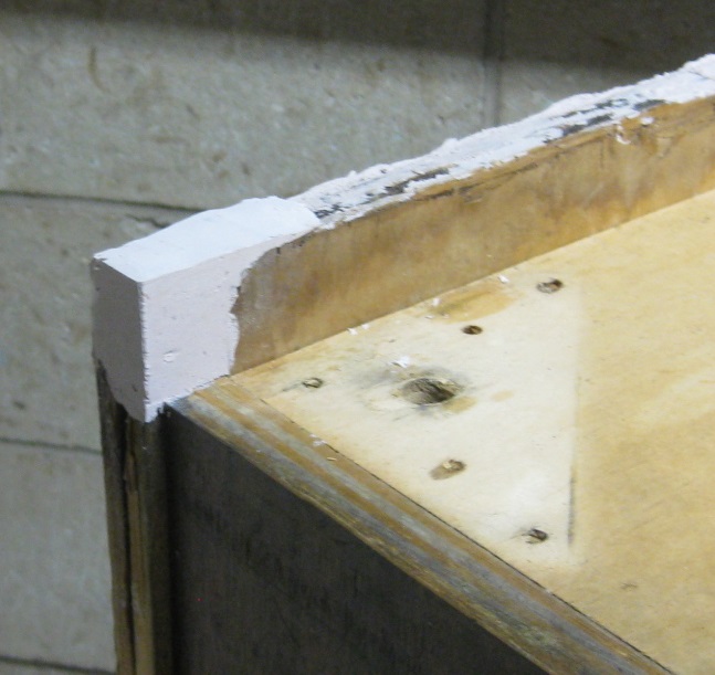

Bondo work continues. Today, I'm re-forming corners. Since I have access to both sides of the wood, this is easily accomplished by taping some scrap pieces of pine to create a mold for the corner, then removing them as the bondo is setting up. The end result is a neatly formed corner. I should only have to sand this down and re-apply a skim coat of bondo once and this corner will be perfect.
The next corner, formed up. I just used plain old pine wood trim boards. They just need to be clean and smooth. When the bondo is setting up warm and firm, you can pull the boards off and the molded bondo will retain its shape while it finishes the chemical process of setting up. During this time, you can also use shaping tools to help form your corner and trim off excess material. Anything you can remove now is just less you have to sand / file off later.

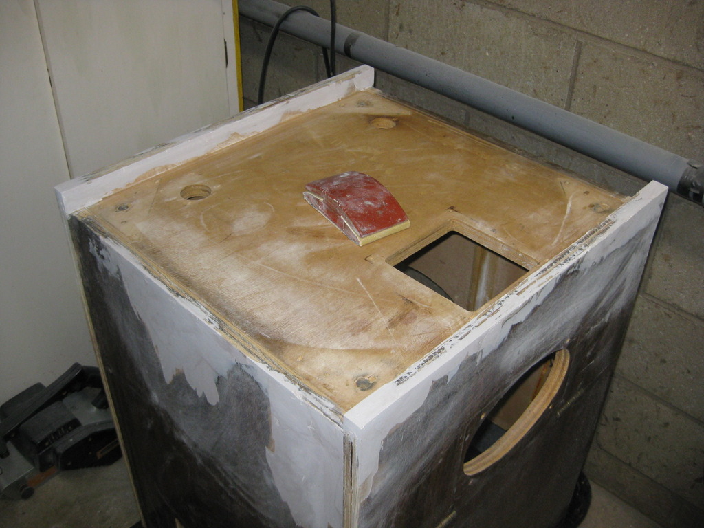

More bondo and sanding. SO. MANY. LAYERS.

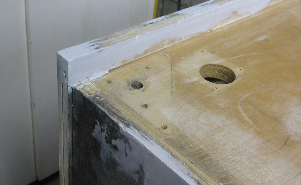

I nearly have the corners formed at this point. Just fill in some small nicks and dings and sand up through 120 grit. Once the corners are done, I can start prepping to spray the underside of the cab black.

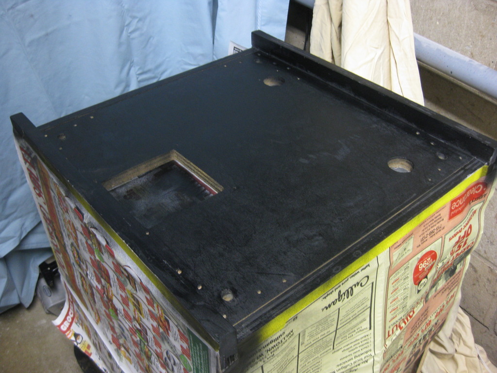

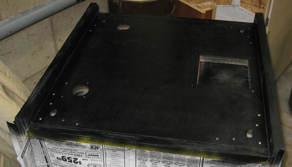

Feeling satisfied with my bondo work on the bottom of the cabinet, I finished it up with a quick spray of black. After the first coat:
And 2nd coat. This is a part of the game that most likely no one will ever look at, but it's important to me that the cabinet has a uniform, finished look. No one wants to look at bondo work, even if it's not in a visible area.
