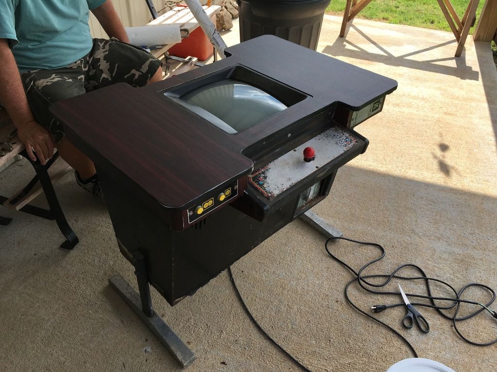

Well, we took the heat gun and scrapper to the old ruined veneer. Once we got that off of the cabinet, we put on a coat of Primer to the bare wood. After that, we let it dry and then applied the vinyl veneer to it. I tried to get as close as I could to the original wood veneer color, because I left one side of the original on it as it had the serial tag on it and it was in great shape.
We cut out the monitor in the vinyl and it looked awesome in person.
We then found the dip switch setting to let the board know it was in a cocktail machine(It is the third one BTW), and we put it in my buddy's man cave where everyone enjoyed playing it!
I still need to get the glass made for it and track down some mounts for it. I am going to try to recreate the artwork for the instructions as that isn't anywhere around. The Sega CPO just aren't recreated by anyone either. Probably due to them being painted on the metal.

I just took a better look at mine and realized the previous owner painted them 🤣🤣🤣
