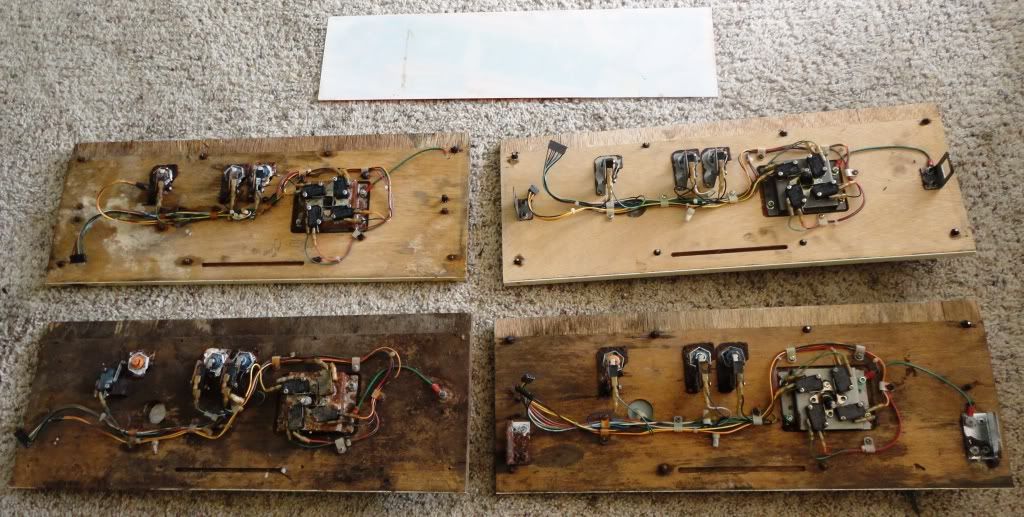

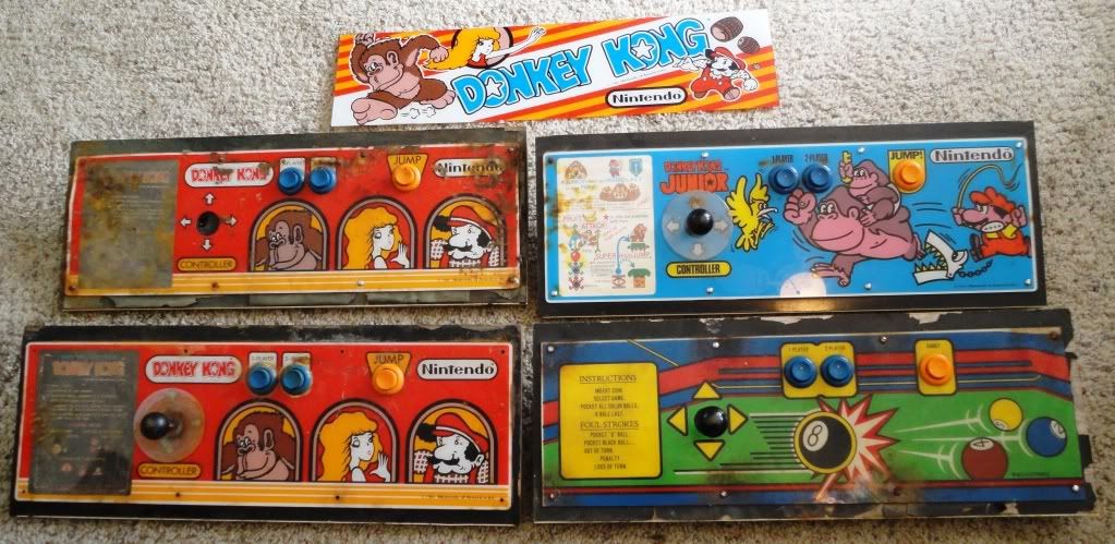

Here is a picture of the Control Panel lot that the buttons came off of for your before picture...
I was only able to save the buttons and 1 DK CPO from the whole lot. Everything else had rotted to pieces. Check out the underside of those CPs...
