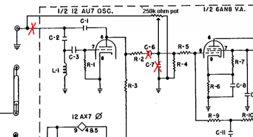

Back to the amp for a moment.
So I read an article by a guy named Carl Haines http://www.carlhaines.com/jukebox/cobra.htm
About modding the wurlitzer 532 amplifier to accept the phono input.
Here is that circuit
Now it seems he is jumping the volume control tube valve and putting the signal after the caps he pulled.
What I do not understand is the why. Are the caps acting as filters? The cobra needle apparatus seems to be refered to a frequency generator.
I do not understand the circuit, and I have not seen anything explaining it yet.
Here is the 518 amplifier partial schematic:
Similar but different....
This is where I am at...
For postarity here is the rest of the instructions for modifying the 532 amp. Again Carl Haines.
"Modifying the 532 amplifier.
These instructions may work for the 530 amp too.
Schematic available here.
Remove C6
Remove C7 Just cutting the leads is sufficient to remove the components. If you leave enough of the leads from C6 behind, that will provide you with a place to attach the potentiometer later. Check the PCB layout for the location of C6 and C7.
Add the 250k ohm potentiometer to the ground side of C7. Use one of the non-wiper connections of the pot to make the connection. You will want to mount the potentiometer to the top of the PCB. Mounting it to the top will allow you to adjust the potentiometer while the amp is installed in the jukebox and will reduce the risk of you lifting or damaging a trace on the solder side of the PCB.
Connect the wiper of the 250k ohm potentiometer to the junction of C6, C7, R4, R5 (the other side of C7 should work).
Move the wire for the center conductor of the input RCA jack from its current location to the unconnected non-wiper connection on the potentiometer.
Set the potentiometer to pad the output of the preamp so that it falls within a reasonable range for the ALC circuit. Measure the ALC control voltage and adjust the potentiometer so that when you play your loudest record the voltage is no more than the voltage when the amplifier is on but muted. On the 532 amp, you can measure the voltage at pin 4 of the muting plug. This is a high impedance circuit and the meter will have an effect on the voltage. Take a measurement for only a moment at a time. How long depends on how quickly you meter can give a reading. After I adjusted the pot, it was set for about 200k ohms padding. Your results may vary."

Apparently in haines got the idea from another on the jukebox listserv. That information is as follows:

RE: stereo magnetic cartridge conversion for a mono Wurlitzer 45-carousel
changer jukebox.
1. Original phono cartridge is the mono Zenith cobra cartridge. It's stiff
compliance, poor sound quality (judging by modern standards) and heavy tracking
are killers for stereo records. Most 45's pressed after 1965 are stereo
recordings. Some of the after market stylus makers have issued a
retro-designed .7 mil tip size cobra needles which helps the tracking issue, but
it's an engineering compromise. It's becoming more difficult to buy cobra
replacements (this translates into expensive) anymore.
2. The cobra cartridge is not a conventional voltage generating pickup,feeding
the grid input circuit of a tube amplifier stage. The cobra element modulates
a tuned RF circuit (oscillator and detector) where the resulting audio signal
is picked off and fed into the input stage of the first audio amp. A new
conversion cartridge with roughly .5 volt signal level needs to be connected
here,bypassing the RF tank circuit. Many ceramic element cartridges with their
stereo outputs "Y"-ed together can be plugged in at this stage. These (stereo)
jukes originally used Sonotone 8T, 9T and variations of Astatic 133 as original
equipment. If installing fresh ceramic cartridge, the Sonotone models are both
freshly replicated. The Pfanstiehl P-132D is being used as a universal
replacement for the others. There will be some minor fitment/arm
balancing issues to address when changing cartridge types. Mag element
cartridges can be used if a self powered phono preamp is inserted at this stage.

both jim and ron are highly respected ppl in this "rebuild" indurstry
the front stage u are looking at is a oscalitor
the cobra's did not work like a normal cartiage
they output a small rf signal
which is then mixed with the first stage "osc" u see in your schmeatic
the then "af" signal is then feed foward for riaa/bass treble/loudness/volume etc
now as far as repacking a cobra
ken/ron/jim are best to answer that 1
also u could try john at johns jukes. ring me if u need the www.
i know he has done a few
but as i explained to u a few pages back
we all ditch the cobra. there is not only $$ reasons for it
the 1's u get from fleabay are junk period
what u need to remeber is the 1600 was the last wurli model to use a cobra
ed
Yet where should the phono preamp be wired in....
I am sure someone has done this to a wurlitzer containing a 518 amplifier....
Haven't they?
right at the volume pot
or u could bypass and go right in behind the riaa circuit
i will d/l your schmeatic and show u
ed
do u see where the first stage coupler tube is ?
it is the 6an8
that is your first af amp (small) as it acts as a stripper
(osc signal removed here)
after that should be your avc then riaa or the other way around ? (ken chime in here)
on the second half of 6an8 u should beable to cap couple the audio from the preamp
ed

now that ^^^ post went the long way around telling u exactly what i stated in short form.
with mag u no longer need the first stage at all (this is the rf osc,stripper,first stage audio
pre amp (af))
as u stated u want to go mag (good move),u need the phono to line amp
alot of the times it will do the riaa for u (equlaition),with this in hand
yes u can go to the second stage (af) amp .1/.47/1mf bipolar (bp) 50 volt or better
cap is used to couple it in.
now if needed u can put a 10k-100k audio taper pot in to control the output of the preamp (phono to line),that shoulkd get u all the way there
ed
