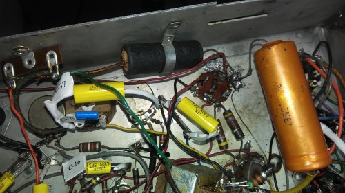

I see two "twist prong" (aluminum can style) electrolytic capacitors in the rear left corner of the picture. They will need to be replaced as part of the capkit. These style capacitors are usually part of the high voltage (450 to 500 volts) B+ power supply and are often the first to fail and take out a power transformer.
If there is a tube "missing" it's probably the tube which controls the Automatic Volume Control circuit. The amp will run without it and many operators pulled that tube out because of "low volume" complaints. The purpose of the tube was to regulate the volume between different qualities of records. Back in those days record recording standards were poor/non existant.
Both vendors stated the electrolytic can caps are not available. They were last made in 1985 according to Bickers.
A mod is now recommended, which I will try to document. It was stated the cans will be unwired, and can remain up top purely for aesthetics.
Depending upon the values of the can style capacitors, some of them *ARE* reproduced by Antique Electronics in Arizona.
The guys at the antique radio forums like to "re-stuff" the old can style capacitors with new caps. This involves removing the old can capacitor from the chassis and hacksawing it open just above the base. Then you boil the old guts out in an old pan you were going to throw away. This leaves you with a clean empty can and room to fabricate a framework of the new capacitors to fit inside the can. After attaching the new caps to the old base connection terminals then you seal up the can and base with either epoxy or simply a wrap with aluminum automobile "muffler" tape.
If your vendors recommended a mod by installing a terminal strip ("tie point" ) and mounting/connecting new "axial" style capacitors, this doesn't always work because of space limitations under the chassis. That's the reason can capacitors were invented to begin with: they free up space under the chassis. Your amplifier looks plenty crowded under there. Also, because wires would need to be re-routed under the chassis, you can introduce "hum" or noise problems if power supply wiring is moved near preamp audio signal wires. There's a reason why the wiring harness is laid out like it is in tube amplifiers.
I may eventually restuff the cans, my uncle has done that, as he is into old guitar tube amps, not so much into this vintage, But I remember he did something like that once, I will have to ask.
Antique electronics has a nice cap selection, and mallory spec stuff, i didnt take a pic of the cans and im waiting on my service manual. For OE. That is the best option around, thanks for the info.
I agree about inducing hum issues, while that is a possibility, and does happen, If I have to add in shielding I will. I am trying to get it working firstly so I can finish trouble shooting the smaller issues.

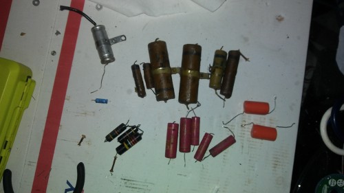

22 OF THE 40 caps installed... These schematic s suck.
The fact some caps had been previously replaced with higher rated ones, some under voltage rated :(
I went through and replaced them all from section to section.
I believe the can caps are going to give me the most trouble, as they have already been screwed with a lot.

Caps replaced so far, I am seeing 2-3 times of caps being replaced. And some caps are missing completely. Tiny value caps off input.
Tomarrow to be replaced

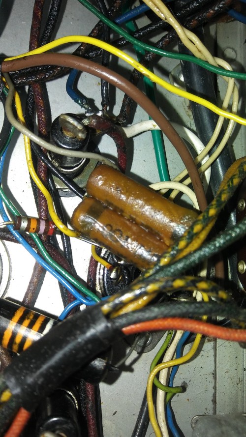

Not sure what this black tube is. A cap but not sure which.... Yet

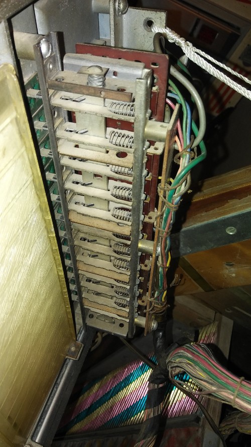

Selectors are dirty..... Should I wash them ouside with simple green?
the switch bank de-xoit

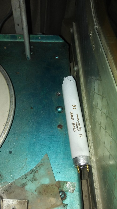

that wire hanging off could be from the flourscent light ?

that black can is a dc filter,u drill out the rivet and find all the info
mind the poliarty
