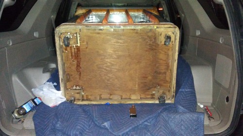

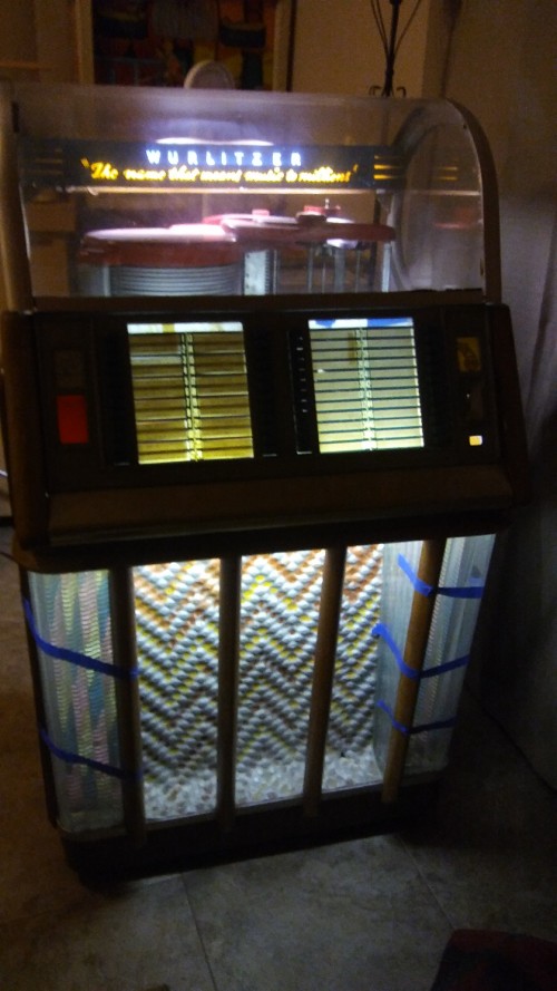

Long story short, met a guy and he needed space, and was willing to let one of his two jukeboxes go. Very nice guy, and I was more than happy to take it off his hands.

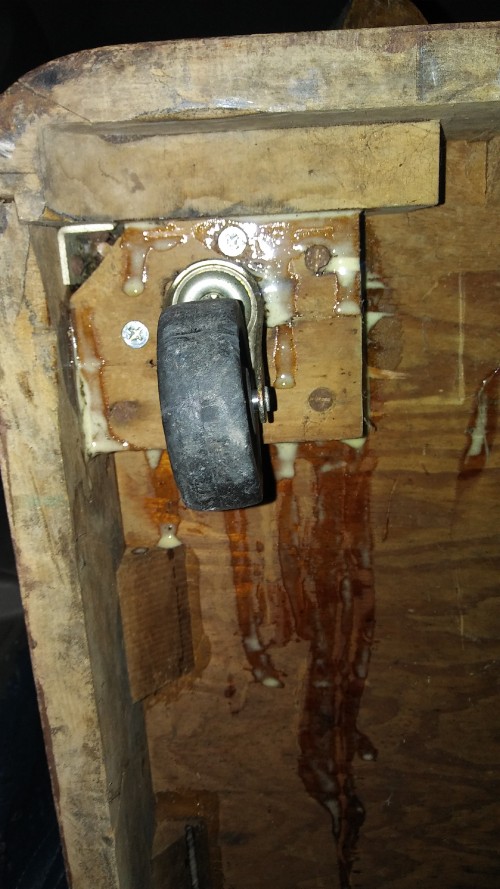

After I loaded it up, one of the wheel blocks fell off. I gorilla glued it and put 3 new screws, and then 3 additional 3" screws to snug it up. Then I placed additional screws in the other blocks. Since I already had it tipped in my vehicle on its back, it only made sense to take care of this now.
Very heavy jukebox.

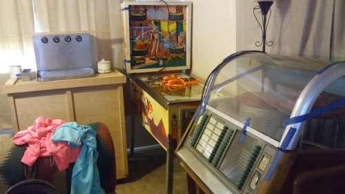

Welcome to its new home:
Yea that is a 4tap kegerator.

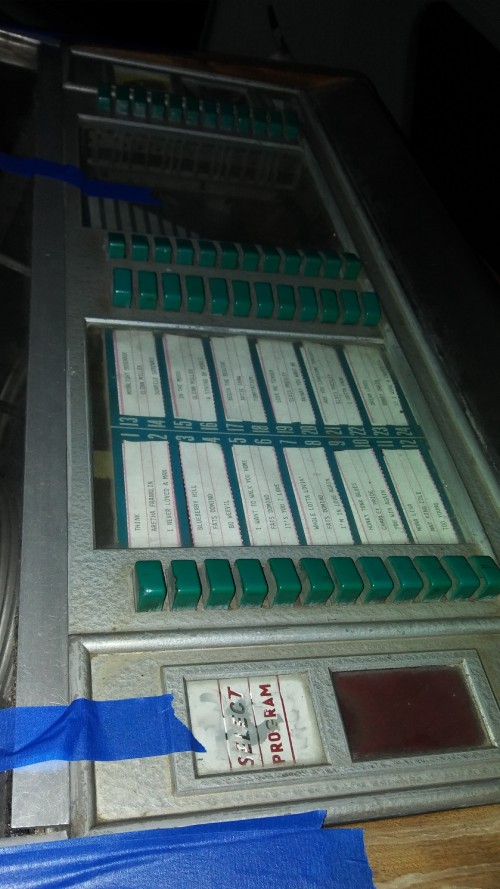

Reset button set back the platter, but trying the selection keys... Causes a buzzing sound from the unit...
Im not gonna lie... The unit is pretty hacked...
Hard to look a gift horse in the mouth... But I hope the original operator (not whom I got it from) bought this jukebox dinner first....
My mistake his mobile site is dead.
It is stuck on record 47. Over and over
I unplugged the coin mech, and was able to select a bunch of records, and it did cycle through them. But it did not reset the mechanical switches.
I was able to play a record and hear it through the amp...
Even manually resetting the notches on the disc... That record still plays.

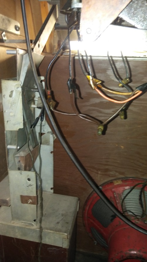

Multiple wires need to be soldered and taped

I almost thought the guy wired the drive on for a display..

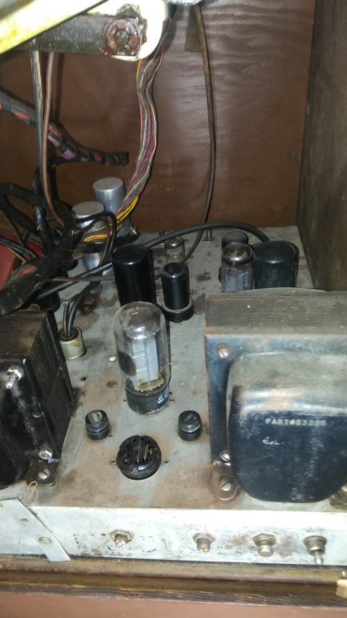

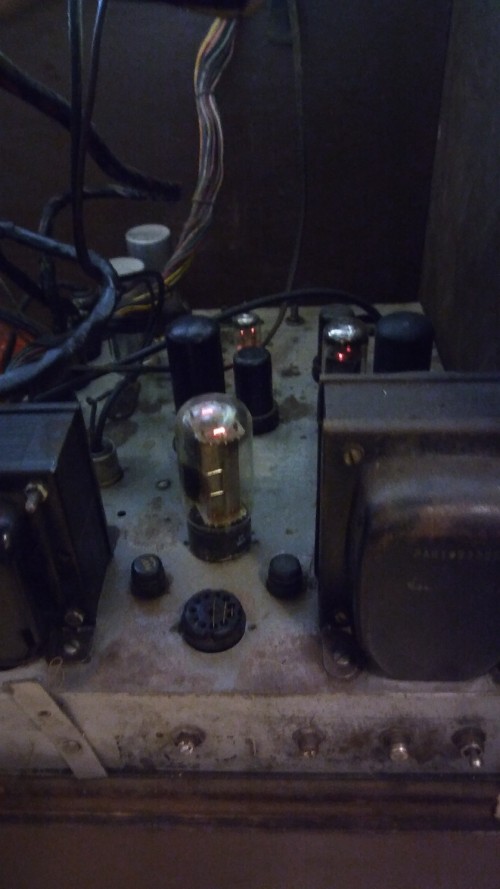

I will have to check the amp tonoght to make sure it is indeed the 518 amplifier. It seems to be a stereo amp but one of the power tubes has a socket in it jumpered to flow power to the other tube for mono.
That vintage of machine must be mono. Wurlitzer did not introduce stereo amplifiers until 1958. Better make sure of your amplifier model number before ordering a cap kit.
518?
Not sure on differences of models yet.
Pretty sure im missing a tube on the back right...
.....preamp tube.. Is my guess. Like a 6j8? No clue. I need a service manual LOL

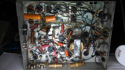

I see two "twist prong" (aluminum can style) electrolytic capacitors in the rear left corner of the picture. They will need to be replaced as part of the capkit. These style capacitors are usually part of the high voltage (450 to 500 volts) B+ power supply and are often the first to fail and take out a power transformer.
If there is a tube "missing" it's probably the tube which controls the Automatic Volume Control circuit. The amp will run without it and many operators pulled that tube out because of "low volume" complaints. The purpose of the tube was to regulate the volume between different qualities of records. Back in those days record recording standards were poor/non existant.
Its a 518... Dirty as hell... Oil in the sockets oil everywhere
A couple of caps replaced at somepoint.
And a resistor to the coin mech socket is blown in half.

Starting with the model 1700 jukebox, Wurlitzer mounted the amplifiers vertically against the side wall. All previous jukebox models had the amplifiers sitting horizontally on a shelf directly under the motor! There is supposed to be an "amplifier drip shield" (a metal oil catching pan) mounted over the amplifier to catch all the oil flung/dripped from the motor and mechanism. It keeps the oil off the amplifier and operators typically removed them. The technicians would take the drip shields to the workbench to use as ashtrays for their cigarettes!
You're gonna need to clean the oil out of the tube sockets. I've used pipe cleaners dipped in 99% isopropyl alcohol to clean the socket contacts. If you don't clean up the oil wherever you find it under the amplifier chassis, it leeches into the old wax capacitors and worse....into the twist prong electrolytic can capacitors and causes them to short circuit thus taking out the power transformer.
I've marked up your amplifier pictures to point out the twist prong capacitors. The major twist prong capacitor manufacturers Wurlitzer used were Mallory, Sprague, Cornell Dublier (a.k.a. C.D.E. ), and Aero. In general, 99.99% of the time, the twist prong capacitors used the metal can frame as common ground (negative in other words). The labeling on the capacitor usually says "CAN COM NEGATIVE". However, on the model 1700, it was the first time I had ever seen POSITIVE ground can capacitors. As far as I know the 1700 was the only jukebox to use positive ground capacitors. I'm pretty sure your 1600 uses conventional negative ground cans, but look on them to be sure.

Now I need tone arm wire
A cobra needle... Or decide to change the tone arm and mod a newer cart. ... I dunno
