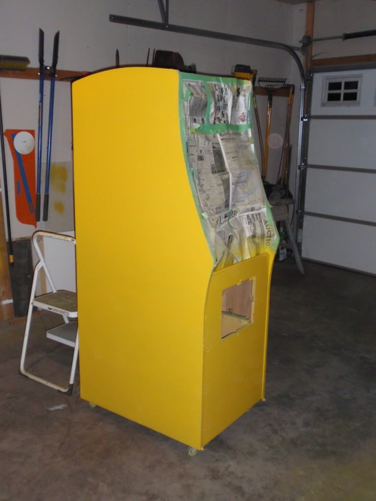

Well, if you haven't read my Pac Man restoration thread, you missed a big one. I had begun spraying rather than rolling my cabs about 1-2 years back. Pacman was my 3rd spray job. Everything seemed to be going OK, but after 5 coats, it didn't seem like the gun was laying down enough paint. I tried cleaning the filter multiple times, but it still seemed to be clogged. Decided to buy a new one. Went to the hardware store where I bought the gun, they were completely sold out of the filters. Went back home, tried to clean it one more time, still seemed to be clogged. Decided I would spray without a filter. Huge mistake. The paint went on so beautifully at first I wondered why I hadn't pulled the filter sooner. I was looking at a smooth, perfect butter cream yellow cabinet:

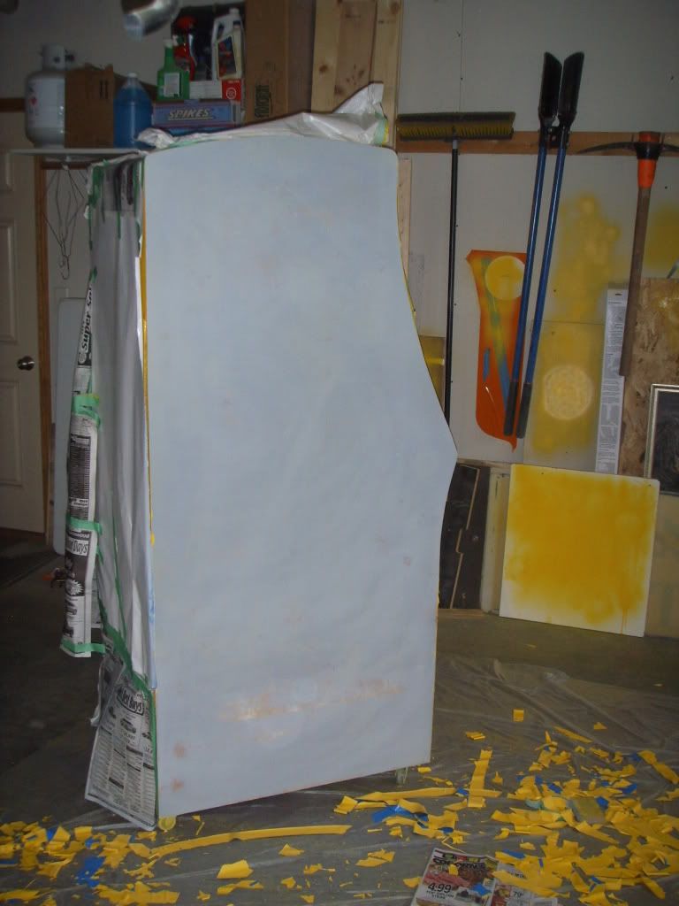

I tried to mask just that area and fix it, but every time I'd test the edge with masking tape, more paint would peel off. I finally realized that in addition to the paint being on too thick, I had also sanded the auto primer too smooth, and there was no tooth left for the top coats to cling too. I ended up scraping that entire side of paint:

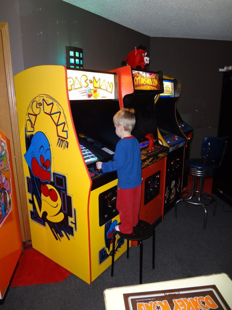

Once it was caught up to the other side, I continued the process and finished the stencilling within a few short weeks. It sucked, but I am so glad I just let it sit for a while and then came back to finish it properly. It is now complete, beautiful and the most played machine in my arcade at the moment:
