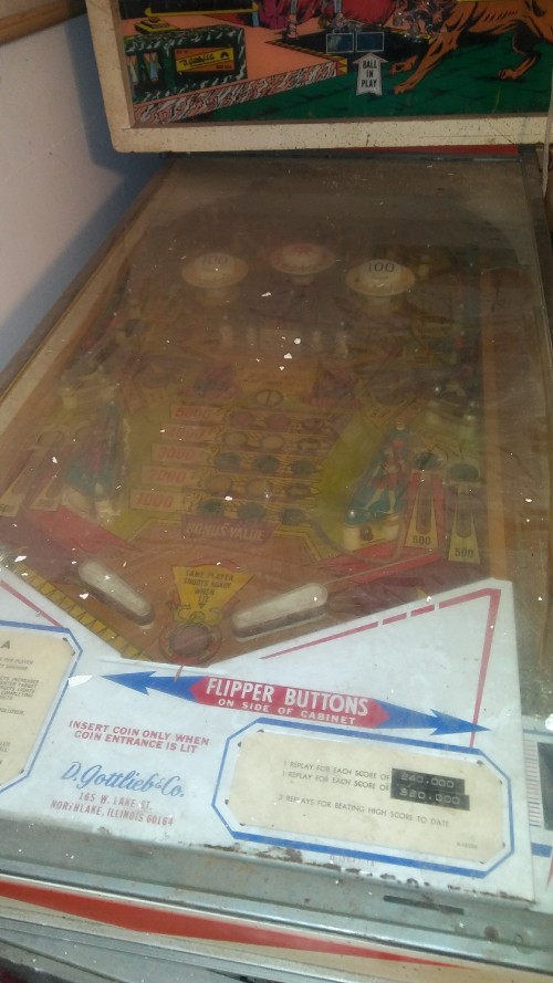

This is a playfield recap.
As I found it:

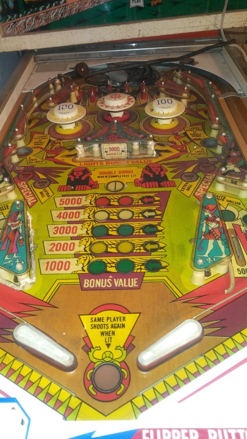

Glass Removed:
Seal bare wood areas, and white back areas to be touched up.
Finished, letting it dry before I wax. Plastics and hardware will be replaced/cleaned after I get my package hopefully tomarrow or sat.

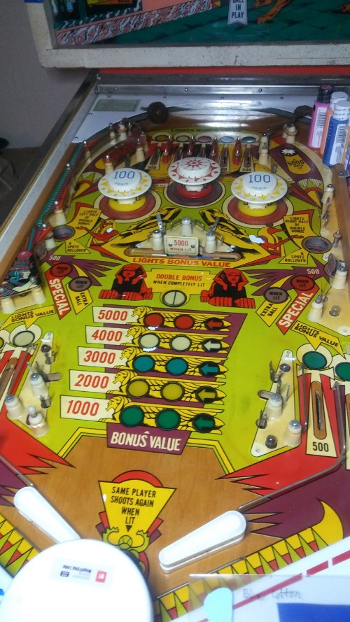

There is a troublesome area on the lower right.... But the clear has tiny cracks and the dark lines are deep. I would have to strip the clear to paint to get them out, and I am not sure that would do justice to preserving the machine... I feel it takes the history away from it.
if you were to strip the clear coat you will have to replace it - titles like this usually aren't worth the investment, i don't worry about the lines and crack in these old playfields - just clean it (not with a magic eraser) apply 3 or so coats of mothers carnuba wax, polish & play
lot of good work you did repairing it
Thanks kenny, this is my first pin, but I love a good challenge. With the lack of repoduction parts for this era of pins, I am limited to how far I can take it. I could strip the clear and spray, I have a setup to do it... I just know I will spend as much as this machine is worth to do so.
That said. I picked up a can of carnuba wax, (non cleaner) and will be putting on hopefully a couple of coats tonight to have it ready for the rubbers and shooter (springs) replacements tomarrow. Ill hit the plastics and give the glass a good clean with invisible glass.

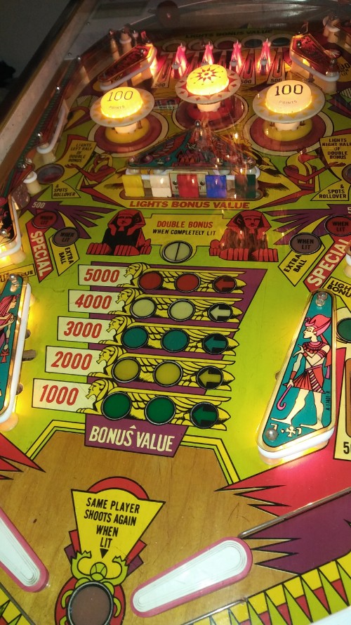

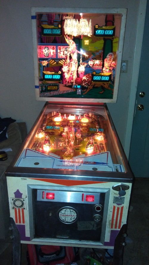

Damned near complete.
Recap
From this
To this
Quick thank you again to ken on that detailed drip target pro tip on cleaning. I had been looking for a few days and have not come across that method. But I will be taking that route sunday night.

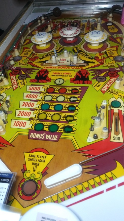

I am not sure about the inserts, every single one is fish eyed...
The ones with txt are actually not bad at all. Which is suprising... Perhaps the larger surface area dissipated more heat?
I have not measuredthe smaller ones from the middle playfield or what looks like larger from up on top, but I am thinking I will be replacing them, and bagging to be put back in the cabinet if someone wanted to reinstall the originals.
I am leaning to replacing the lights with led bulbs, and the inserts with the colored transparent starburst designs that are available.
Currently it is very hard to distinguish between whitr and yellow, and blue and green...
Thoughts anyone? I will staple the originals inside the cabinet. But I want to replace them.
