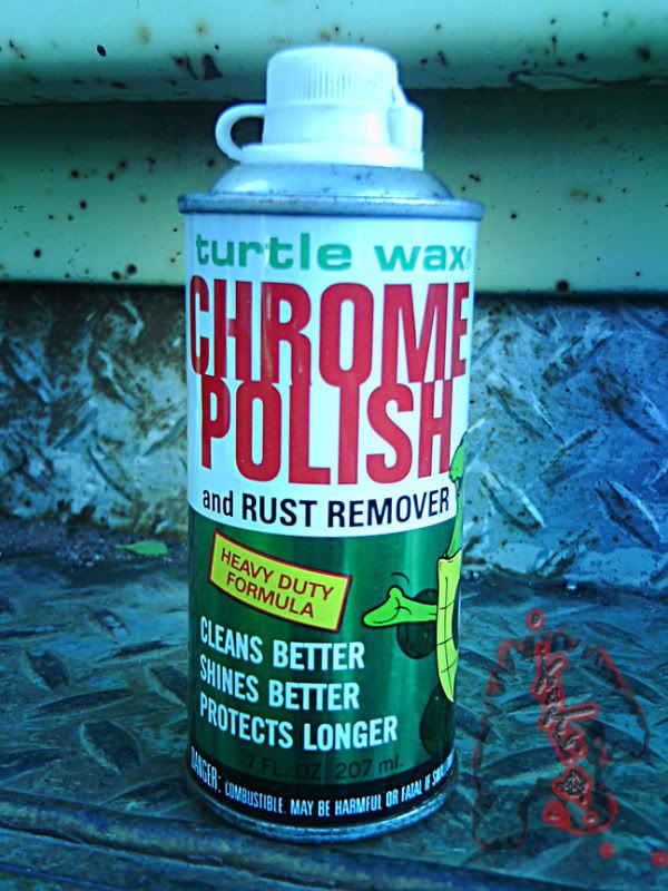

Turtle wax chrome polish works very well on lightly rusted chrome parts.
