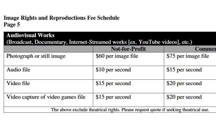

...but there's a problem. In order to show the Strong Muesum scans in the video, I need some funding for the licensing and rights to these images. I didn't want to make a fundraiser but with my current situation, I feel that I have no choice but to humbly ask for your help. Any left over money will go towards other (more important) stuff like rent and food.
