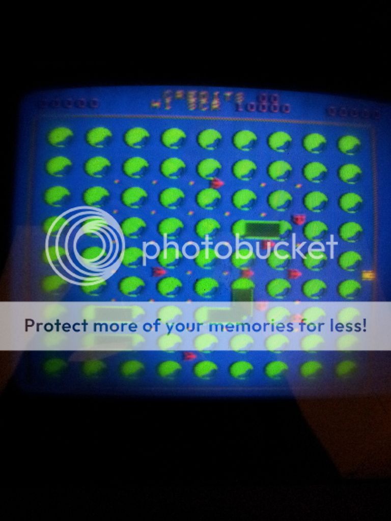

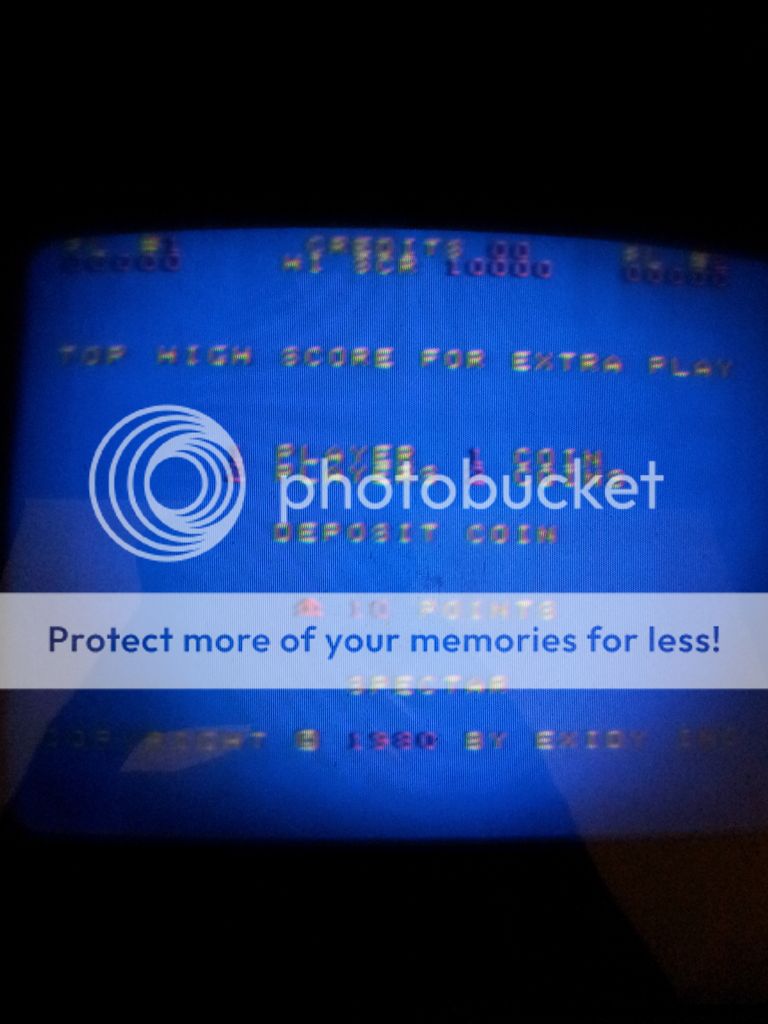

So I stayed up a little late last night doing some research. I discovered that the cap I'd blown was on the audio board and not on the mainboard. Well, I had known that it wasn't on the mainboard but I wasn't fully aware of the function of the little board stacked on the mainboard. I was tired and assumed the third board attached externally by a ribbon cable was the audio board but nope I was wrong :D.
After this happened, I remembered back to when I got my Targ cabaret and how it played but didn't have any sound. Then I remembered how we determined that the audio board wasn't connected as the wire harness plug was just dangling loose away from the audio board edge connector. Then I remembered how after plugging in the audio board the sound still didn't work because the speaker wasn't hooked up.
With this info, I busted out the Spectar boardset once more. I plugged in the boardset but left the audio board disconnected, plugged in the machine, and...Hurray! I smelled/saw no smoke or fire.
This was the result:
So... Spectar boards play! I just need to repair the audio board!
