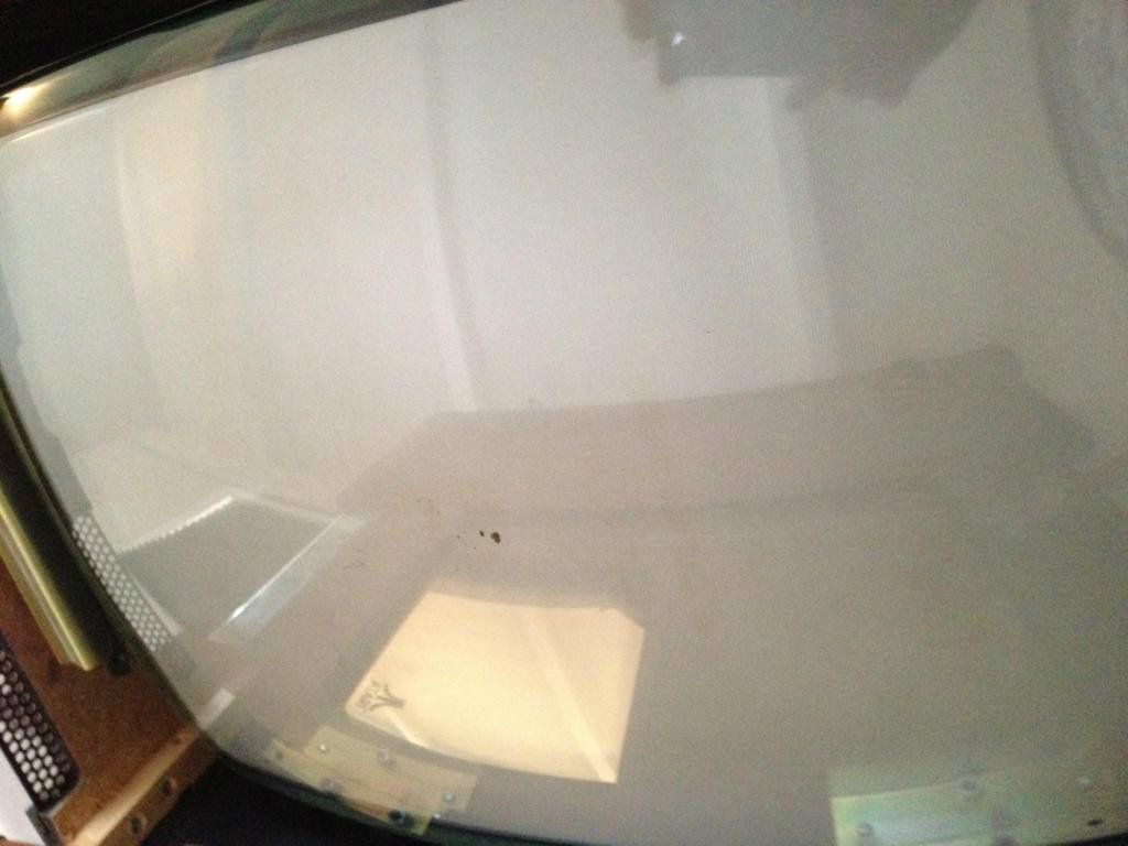

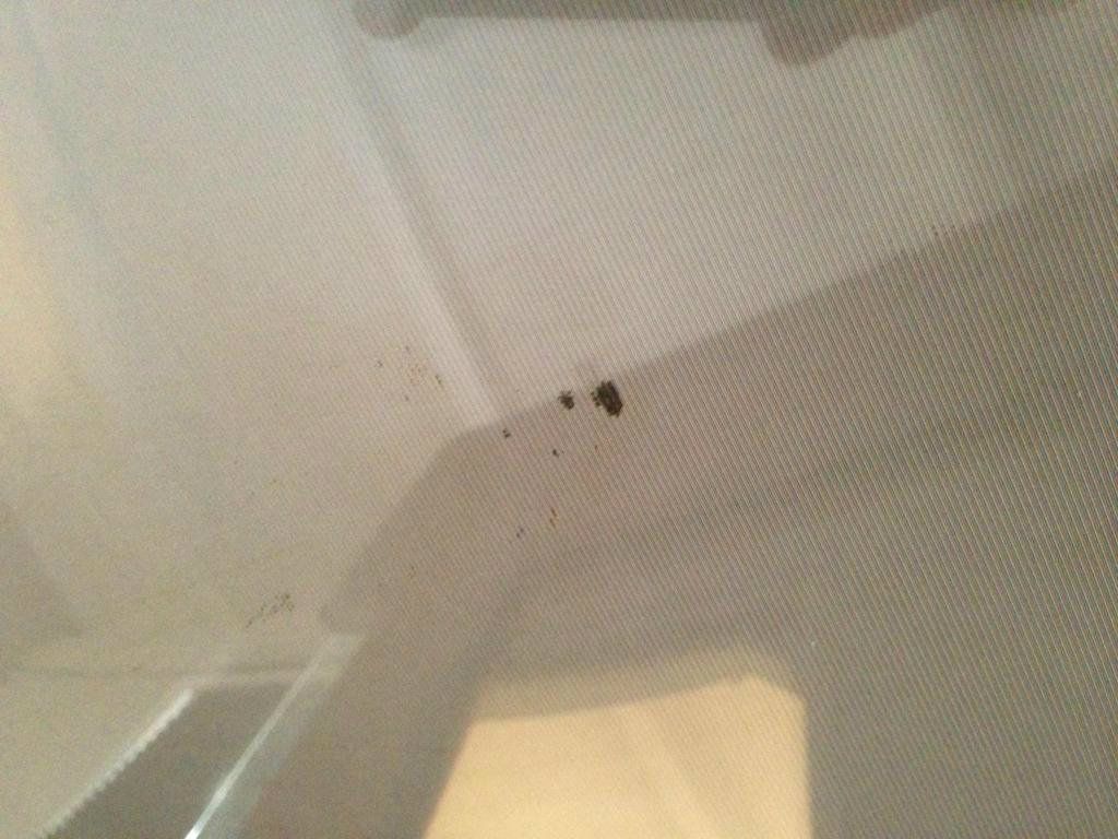

The most glaring issue with it (to me) was that it had some phosphor burn in the middle of the screen:
It was honestly hard to see behind the smoked plexi, but on some screens it would slightly interfere with the game image. Here's an example with the test screen, you can see a couple of dots in the middle:

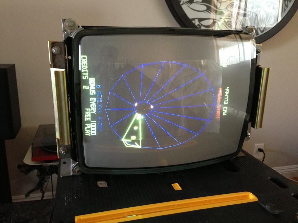

You can see that the picture looked pretty good without even doing any adjustments yet (the clear plastic protective film was still on the tube in this pic):

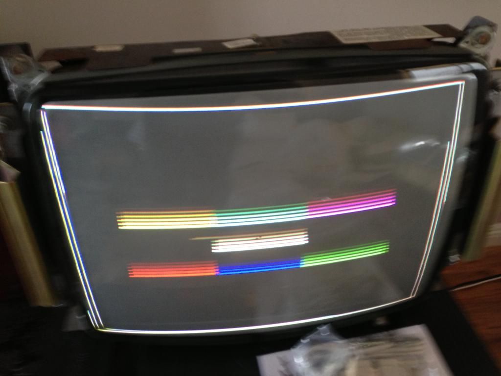

But I wanted to get it as good as possible so I went through the entire adjustment procedure described in the WG6100 manual and the FAQ Guide. It generally consists of moving and tightening the yoke to get consistent green, red and blue cross hatch patterns, and then adjusting the magnet rings to fine tune the purity and superimpose the red, blue and green lines of the cross hatch patterns. The WG manual says that you can also tweak the horizontal and vertical orientation of the yoke after that to adjust convergence at the outer edges of the picture, but I didn't do that, it seemed unnecessary because the picture was already looking good. Anyway, then you can adjust the bias and drive pots on the neck board to fine tune the tracking while displaying the seven groups of vertical lines – follow the directions and you'll know it when you see it, the groups of lines will be perfectly colored when properly adjusted.

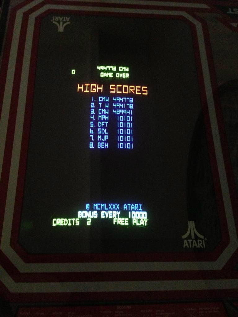

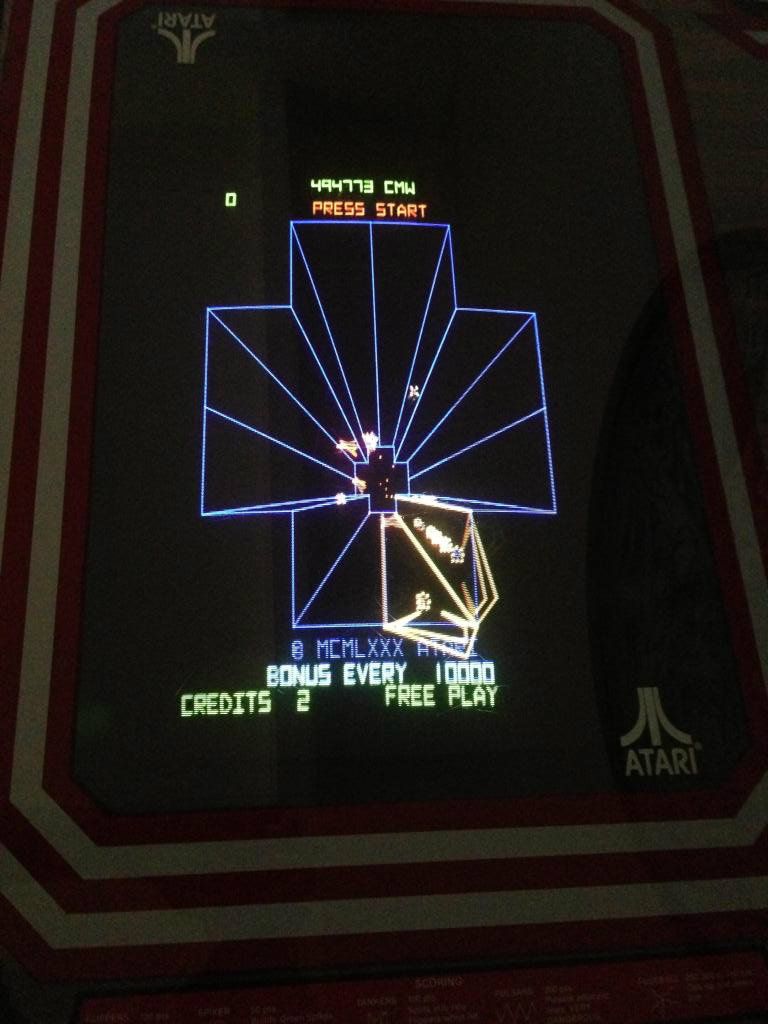

Fired up the game and the new monitor looks great:
