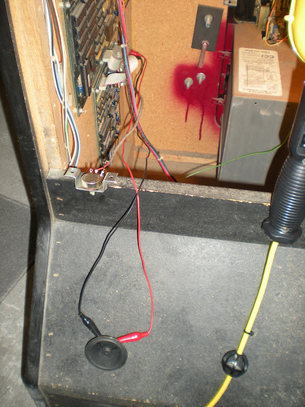

The amp in my Mortal Kombat sound board went, and I am getting very quiet sound. I figure the capasitors in the sound amp went, so I am ordering replacements.
My question is, what caps should I replace? I am planning on only replacing the electrolytic ones.
Has anyone found they had to replace the other types too?
Also, is there a particular brand that is better than others? I don't want to replace them with ones that are going to go bad again.
They are both electrolytic caps. the one on top is axial (leads on each end) and the one on the bottom is radial (both leads on the same end).
(figured someone may not know that)

The MK 1 model I have does not have any menu for adjusting the volume, it is done with a pot. I plugged right into the audio out on the sound board (by passing the main board and jamma harness) and have the same issue, so I know the problem is with the audio amp.
It does play sound, just very quietly. The volume pot tests out fine at 50K resistance. I did re-seat all the chips just to make sure. I am pretty confident that the problem will be solved by replacing the capacitors.
Now I have 3 projects to replace capasitors, My TurboExpress (already replaced some), My wife's monitor, and now my MK1. I figure I will order them all at once. Damn capacitor plauge!
What is that speaker you are using to test the amp? Speakers are not all equal and you cant assume that if its smaller it will be easier to drive. If you are getting very quiet sound its possible you have a speaker with the wrong impedance.
It is a 8 ohm .5 w, the original is 8 ohm 2w.
Is that harness to the pot factory? That doesnt look right to me. I want to say that the correct harness had three wires on the pot not two.
Matt
Matt
This pot is good, and it worked with this post for months (since I got it) I don't have the manual right now, but it believe it only uses 2 of the pins.
