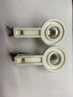

Hi,
I am trying to find replacement leaves for my asteroids deluxe. One of them is in bad shape and despite my attempt to clean and tune, I can't get get it to work reliably in the heat of battle. Do you know where I can buy a replacement that would fit? I see a few places sell leaves, but not sure which one I need. Thank you!
What have you done to try to clean it?
Note that you have the 'crossbar' type of leaf switches. Those have small metal bar contacts, instead of the larger brass button type. The crossbar type are designed to be self-cleaning, because the perpendicular contact rub against each other when they make contact.
There isn't much to these switches. You can clean the contact point with a Qtip dipped in some acetone or Goof Off, to break up any grime. These can be dirty, as all of these games were operated in smoky bars and restaurants, which covered everything in nicotine.
But you shouldn't need to replace the leafs here. If you are having issues, it may be something else in the wiring, or even the game board.
Best thing to do is swap that switch with another one on the control panel, and see if the problem follows the switch. If it doesn't, then it isn't a switch problem.

Thanks. I'll try swapping tomorrow. The leafs on the one button are terribly corroded. I tried cleaning them with the usual ways I see suggested. The metal is in pretty bad shape.

Hi Thank you to everyone that replied. I soaked it in white vinegar for 2 hours and then scrubbed it with a toothbrush and it cleaned up nicely. It was super nasty! Put it back in and it seems to be working great now. Previously, it would seem to miss once about every 8 times when I hit the fire button quickly. All good now, but I need a new excuse for my low scores.
