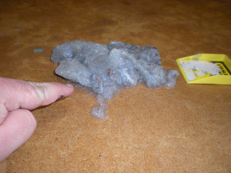

So I am cleaning and repairing a busted up a 4 Player Simpsons and painting it black. I stripped the artwork off one side after painting over the vinyl on the other. I used a heat gun which worked like a champ, but there is still adhesive on the cabinet, and if I try to put the belt sander on it like that it will rip the paper off. Is there some secret to getting the glue off? Acetone?

It can be a slow tedious process, but perhaps someone here has the silver bullet. When I have done this in the past and wanted to keep the paint under the art in good shape, I generally spray Goo Gone gel (different stuff than the normal small bottle) on the side, spread it around by hand so everything is covered, let it sit for about 20-30 minutes (varies depending on level of adhesive/paint/etc), and then start taking it off with a razor blade. This has always worked well for me, but it does take some time- a lot more time than actually taking off the sideart itself.

Anyone tried acetone?
Use adhesive remover. Go to a sign shop and ask if they will sell some or goto the drug store in your area. Should sell it there. Its a long job but works well. I went to sign shop and got it from there. Either way it's a job if it's been on there for awhile. And use a plastic razor blade to scrap the adhesive residue off. The plasic razor are great for they don't scratch a's bad if any on what you are scraping on.

I've used Goof Off a few times for that, and it worked great. With Goof Off, I would always try it in an inconspicuous area first to make sure it won't strip the paint from the cabinet.
I used it to get the sideart adhesive off my Mappy and Baby Pac-Man. Spray it on, then use a paint scraper to scape the adhesive off. It will gel up into a goopy mess, but will come right off.
The best stuff to remove glue from decals is Rapid Remover. Has a citrus smell to it, just spray it on and wait a little bit, then wipe off the glue. It works great after removing any decals on vehicles and such. I buy it by the gallon for my lettering.
I figured it out
Buy a big can of Acetone and a plastic stripper at Wal★Mart and go at it. Really works! Look at that huge glob of glue!
Goo Gone (regular and Xtreme) didn't do as good of a job as regular Acetone!
I wanted to add that don't use goo gone because the oils soak into the wood. I cleaned the area I tried goo gone with mineral spirits, hopefully the paint will stick. The area with goo gone was almost impossible to sand. I think I will go over that spot with a heat gun to vaporize the oils.
If you are in the same situation just use acetone.

Looks like the acetone did a good job on the adhesive though! And probably the most inexpensive way to do it.
