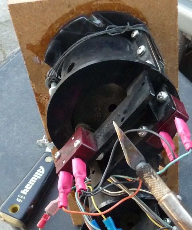

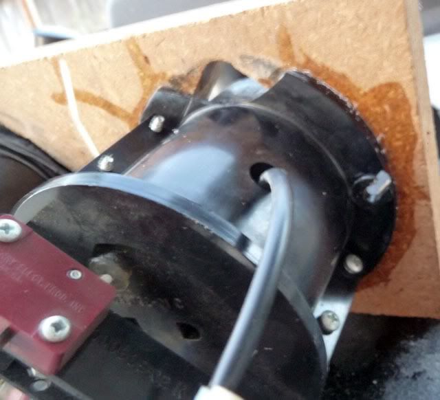

As I am taking apart my Battlezone controls to rebuild, I am stopped by the fact that someone GLUED them to the wood. Plus are already look pretty broken up. I tried a hot gun, but didn't want to heat up the plastic too much.
Then I tried my hot knife, hmmm, didn't work much either.
I need some ideas on removing the Control Handle Housing from the wood?
Don't ask about the wire, very "jerry-rigged" together.
Thank you,
Steve
Try nail polish remover, that stuff is the clue removing master.
KrisK you are a genius!
I put a little nail polish remover around the base with a q-tip and within
a few minutes, BOTH handles where off of the wood base.
Man it was like MAGIC!!!
Even did a video for my blog of me ripping the handles off of the base!
Steve
