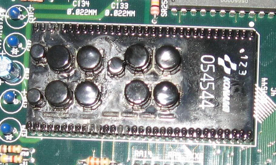

I've been searching the last few hours for an answer to get my 6 player xmen's sound in operation. I attempted to remove the chip from my 4 player with zero success. The chip is very brittle and broke. I am now going to just repair the original chip with new caps. How do I remove the caps?

No problem. I know how to remove everyday stuff from a pcb. But these caps have some kind of coating over the entire chip. I don't know if I can access it from the underside of the chip. But in order to get to the underside of the chip I have to remove solder from 64 pins on the bottom and then 64 pins on the top.
The problem with that is mulitple...
The electrolyte likes to eat things... like the painted on conductive traces near the caps AND where the legs solder to the top and bottom of the module.
Additionally the solder used on it is contaminated by the electrolyte and is a mother to try to remove. The last (and only!) one I tried to repair ended up a disaster. I removed the caps by peeling them away from their legs, breaking off the plastic base, then desoldering one leg at a time. It took a LOT of heat to do this.
The module needed massive amounts of rewiring with Kynar wire and after all that I discovered that the electrolyte ate the traces on the bottom of the module too. At that point I gave up.
Maybe some super genius like Spaeth can come to the rescue of every owner of a Konami game by redesigning the hybrid module. :rolleyes:

On the module I was working on this couldn't be done as the electrolyte ate up things on the bottom side of the board too.
Oh... and it would only work until the electrolyte spread to the bottom of the board and ate it... which it would eventually do if you don't remove the bad caps and clean all the electrolyte off the module.
What would you suggest to clean of the module to get rid of the electrolyte. I just replaced the one main cap that had a minor leak and another cap at the top of the module. The sound is now loud and clear from one speaker but nothing from the other. I am going to leave it alone until Monday and replace the rest of the caps.

Not sure... I tried 409, 409 orange, flux remover, and isopropyl alcohol... nothing would touch that stuff.

I have a couple of bad hybrids here... # 054544 and 054986A
Both hybrids have 3 chips on the bottom:
  1. QFP Chip: Konami # 054321
  2. SOIC chip: AD1868R
  3. SOIC Chip: 4558
If you power up the board without the hybrid it will work but your sound RAMs, ROMs, and custom ICs that are related to sound will show up bad on the self tests.
If the hybrid is cracked into 2 you'll end up stuck at a "ROM RAM CHECK" screen. ;) (I had one in for repair that did that.)
The only way to fix a hybrid module is to get lucky and replace the caps before too much damage is done or to find one from a donor board.

Thanks for the info on the chip, I'm trying to figure out what the voltage is for these caps. I'm basing the replacements on the flippers repair site schematic:
http://www.flippers.com/images/Fujitsu_MB3722_Capacitors.JPG
Current status of my sound chip:
http://i27.photobucket.com/albums/c196/cyberfluxor/QnA/konami_054544.jpg
Trying to get the caps and repair this before Saturday. :)
According to this:
http://garakuta.homelinux.org/~nosuke/tsubo/files/misc/054544_memo.pdf
It looks like 16 volt.

My big question is, what is the purpose of the chip? I was thinking we could move to a car amp for the audio amplification, but that is handled by the other chip MB3733 or whatever near it (on the heatsink.) The Yamaha chip below it is probably the fm synth for the background music. What does the 054544 do? Digital audio?
  3. SOIC Chip: 4558
QFP = konami custom chip... prob a MCU, if you're getting errors w/o it...
AD1868 = dual audio DAC
4558 = opamp (pre-amp after the DAC)
Those pins on the hybrid are pretty fragile... good luck even removing that hybrid w/o damaging it further, let alone decapsulating it for repairs...
Safe bet of 16V on all caps is good... that hybrid shouldn't be seeing any more than 12V...

The problems with taking those caps off the hybrid is that the silly white ceramic substrate makes a wonderful heatsink. It pulls off the heat too fast and makes it difficult to desolder.
As for the pins, they are easy to desolder if you have a good desoldering station. I have a couple of Pace units here and they'll desolder the pins cleanly.
