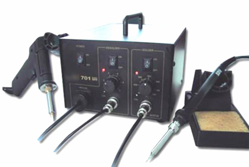

Do you mean "joins the suction tube"? Just trying to see if I can improve the suction on my desoldering station:
I really need to turn up the temp to see if I can get cleaner removal of devices from the board.
CSI701A
Be wary of the cheap desolder stations i have had one of these see link for a couple of months, used it about 30 times and already had to unblock it twice and now the vacumm wont lift the solder off of the board, i'm already saving for a pace as it has a larger heating element that receeds back down the tube to stop blockages.
