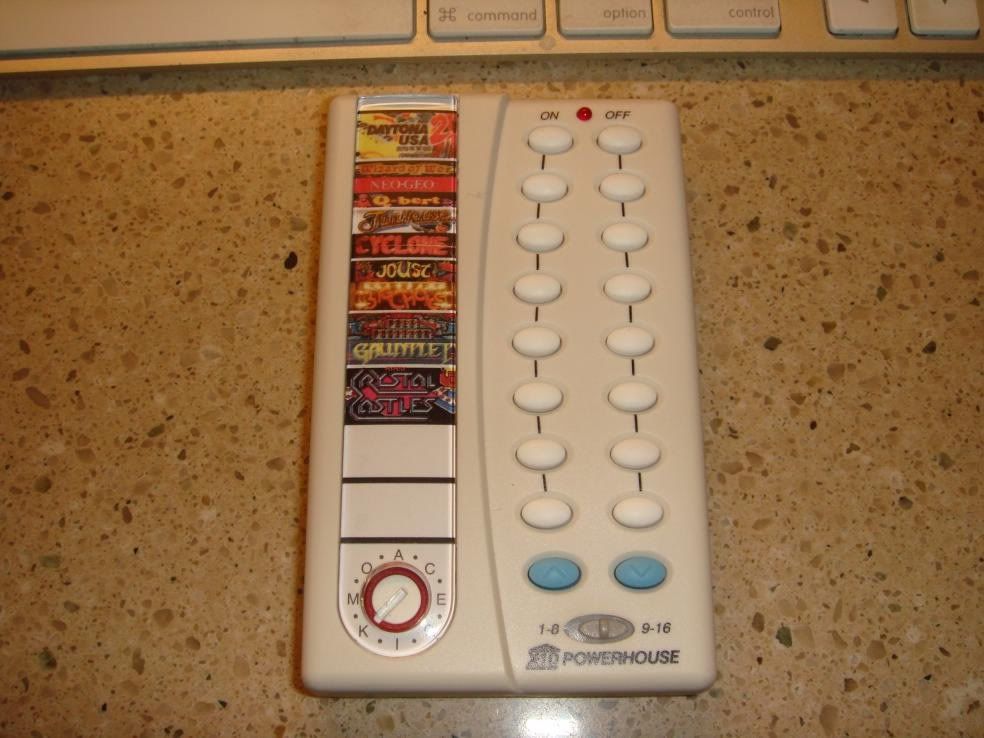

You could do 1 for 1, but these are rated for 15 amps each. I have mine grouped in 2-3 machines per module as I only wanted 8 modules to make the remote cool. I printed the game marquee's on the remote as the button labels. It's pretty flexible based on what you want.

This was what I did with the X-10 remote.
Not as sleek as the Harmony, but I like it!
It's a good thing we don't live next door, I use the "K" house code too!
It would suck if you were setting a high score on Crystal Castles when I hit button K-6 at my house to turn off my arcade lights. :D
