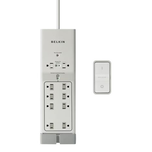

Belkin Conserve power strips. They have a 10 plug and 8 plug model. I have 5 of these around the arcade controlling anywhere from 5 to 10 arcade games and signs per strip. They are rated for 15 amps, and also have a built in surge protector. You can program each strip to use the same remote, or have each one on an individual remote. Personally, I love them.

Can you turn on each outlet individually, or do you have to turn the whole strip on?
This is what I use. I have two and they both turn on with the same remote. Highly recommend them.

Also, you can plug a powerstrip into a module, but be careful on the total load you have, they are only rated for 15Amps and doing a few games at startup will probably be more than 15Amps. I'd do 1 game per 1 module to be neat & clean.
Can you get any pics of the unit that you plug your game into? Trying to see if I could fit 2 of them on 1 power strip.
