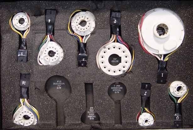

ps here is a shotof the adptors included can you tell if these will cover my needs arcade wise

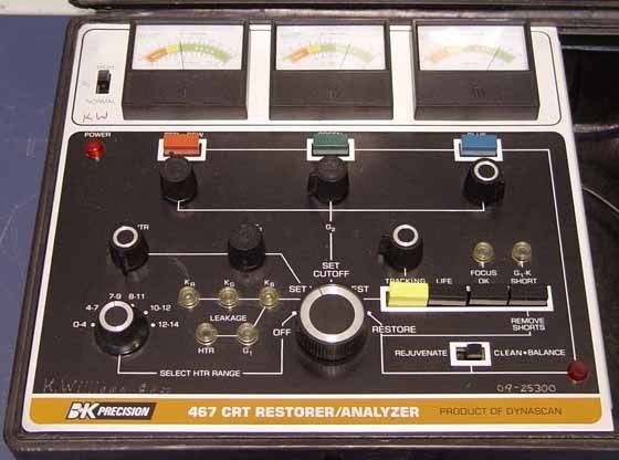

well made an offer on a 467 and the guy accpted it 60$ even including shipping
thats a little more than i wanted to spend but guy game me a doa waranty so as long as it works ill be happy

does it look like the adptors included will cover me for most monitors (arcade wise)
if not what ones should i buy
and what is a good source to purchase ones for this rejuv

I have the 12 pin connector and pins that you need. $4 shipped, but you have to tell me the gender as some 467's used male and some used female.

ok got the reuv today before i plug it up to my si m5000 idlike to test it on one of my burned color monitors
there are 2 adptors that came with it that look homeade andi think will fit on one of my color monitors
? as a genral rule if it fits the tube it wil work or are there varaitions of wireing and even tho it fits it may be wrong
in the pic above th2 and third ones from the left on top row
and first from the left on the ottom row are all home made
