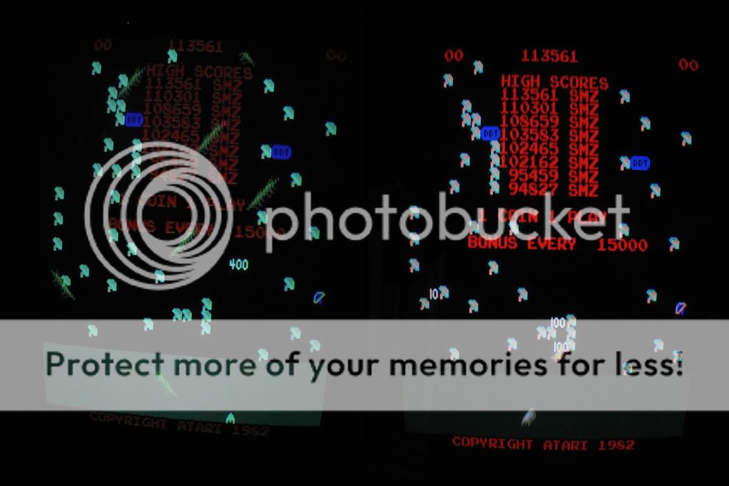

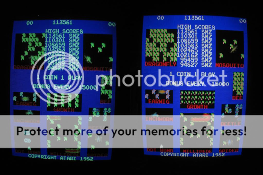

I will let you guys figure out which one is before, and which is after... :D Just thought I'd share these pics, since I haven't seen too many out there showing good results. Man I love this thing.
I had the local TV repair shop rejuvinate my 25" monitor for my T2. Well worth the $$$.
Those results are beyond incredible. Where do you get one of these again??
Actually, I think the "before" pics on the left are slightly generous -- it was very dim and washed out. I think the camera's shutter speed was slightly longer to compensate for the darker picture, so in real life, it was even dimmer than it appears in the "before" photo.
And both photos are taken with the smoked glass on. With the glass off, it's ridiculously bright now. After rejuvenation I had to actually turn down the brightness and drive controls because I had them pretty much all cranked.
Just got it on ebay. About 30 bucks shipped, but I had to wait a while to get one for that price, and with a good collection of adapters. Klov has ruined me... :rolleyes:
