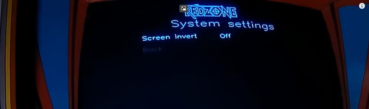

I'm trying to install one of these boards in my full size BZ but the image is either upside down or backwards.
Did you have any problems with yours?
Did you go into setting?
No I didn't. The installation page on arcade shop's website didn't mention that. Trying to read backwards instructions on the screen is a little tuff too. I'll see what I can do.
Use a mirror.
The reason is Battlezone used a mirror so the image is backwards on purpose. So the settings has the option to reverse it if you are not using a mirror in your cab.
