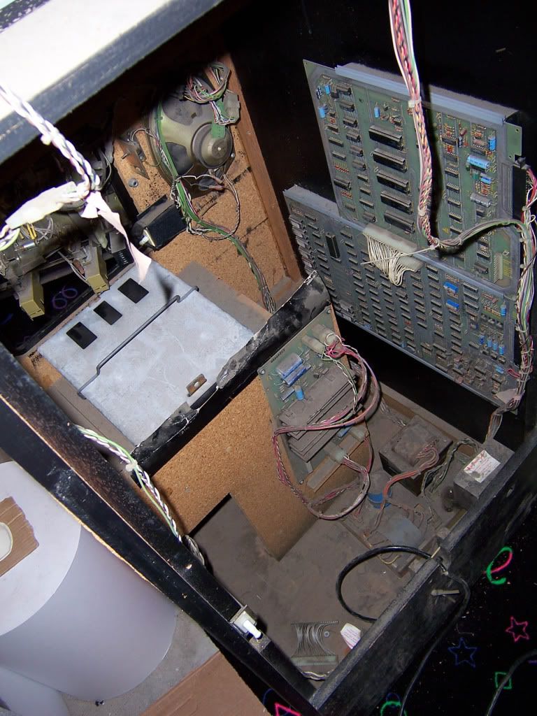

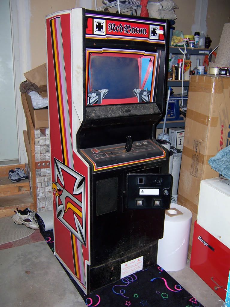

Well everything was in there so I plug her in and see what happens. Boards light up, but no sound, no monitor, no lights, and no playing blind. Looks like I will have to repair this one. Who wants to help? :p
Resolder the board interconnects... then resolder the connectors on the AR board... After that, check the fuse holders the rest of the power brick.
If it still doesn't power up, check for corrosion on socketed chips.
After that, punt! Time for someone to dig into the PC board. ;)

I think your B+ voltage is out , cadillacman and i both agree ,,,, The cab needs to be sent to my address here in OZ , for a full check up !!!
Mate , what an awesome unit , i am very blown away , good luck with it , it sounds very minor , on a serious note , you are very lucky !!!!!

I see a spare interboard connector in the bottom of the cab....
And the power cord looks like it is damaged near where it enters the cab.

Pulling chips as we speak.
