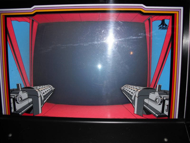

Hey I scored a Red Baron project from Todd up in Flint, Michigan. Really nice guy. We were going to have to bring it up a flight of stairs so I brought along a friend and his wife.
After a very long drive-about 3 or 4 hours we arrived and his hospitality and conversation kept us there an additional 2 hours. Really great guy.
Anyways. Here's the beef of the post; Someone was in the middle of converting this Red Baron to a Battlezone. My objective is to convert it BACK.
So, my problem starts with the two wings that have been removed from either side. Does anyone have these laying around? They attach to the upper portion of the cabinet where the monitor sits. All of the problems stem from that area.
I also am in need of some plans or templates for the upper marquee wood and what sits just below the monitor to hold the plastic bezel in place.
I'm going to need some pictures/templates/measurements - something so that I can either fabricate these parts or perhaps someone else has them after they did a conversion of this cabinet. I'd just like to get this cabinet back to a Red Baron. Thanks man.
I see, so I actually need an 'Open Faced Conversion Kit'. Brackets and all.
Those pieces would just be covered in white vinyl though, right? I know it's way easier said than done, but if you could borrow that assembly from someone, it could be replicated from particle board, vinyl, etc.
Someone had an open faced kit for sale here a while back. He might still have it. It looked complete. Do a search for it, you might get lucky.
I think that was wolfeel, like back in Jan. It's marked SOLD.
Seems like that is going to be a hard find. If I could find one, I'm wondering if Brett could plug it into his CNC machine for others that may need one? The metal however would be hard to get fabricated without buying enmasse.
Is anyone making the cardboard bezel? I'm thinking that's what the guns are and not screenprinted on the plexi bezel.
