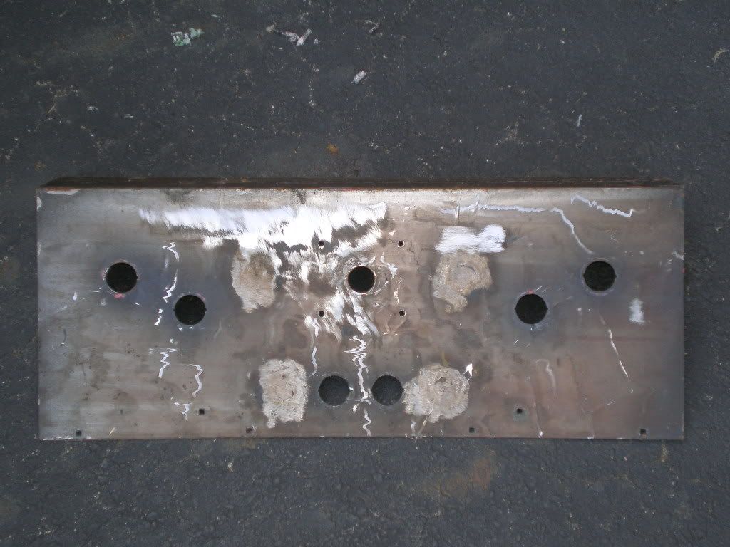

I have a TnF CP that was converted to a Rush and Attack CP so 4 of the holes were welded off, 2 on the player select and then 1 each on the run buttons. I want to recut those holes out without damaging the CP. What would be the best method, any advice?
Get a hole-punch kit from Harbor Freight, Home Depot, or your preferred tool shop. You want one that has a 1-1/8" punch.
You drill a small hole in the center of where you want the button hole, put your punch-out pieces on opposite sides of the control panel connected through that hole, then tighten with a wrench and it punches out a perfect hole right where you want it - with smooth edges and everything. Ken recommends spraying down the punch with WD-40 first, and that helps it go through even easier.

Thanks man your information is always appreciated. I forgot one thing, holes were welded so on other side you can see the bond from the weld and it's avg weld thickness. Will this that u speak of cut through that?
ive been drilling them out with a hole saw. a little cutting oil and a pilot hole, bingo.
drilling a bunch of holes takes a little while but with the cutting oil, i only needed one bit to do it. still need to duburr the edges but they really came out nice.
interested in the hole punch route, will go check one out.
