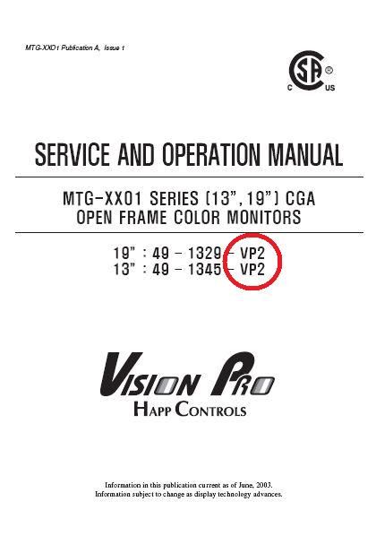

Nah, it's a VP2. I'll bet it says so on the manual that was in the box. The VP2's have been out for a few years now...
Ah okay; that's what my Vision Pros are too (I just looked at their manuals). What changes were made from the Vision Pro "1"?
