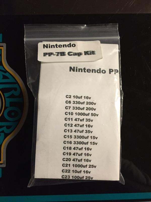

Guys,
Do any of you have a list to replace the cap's on the Donkey Kong Power Supply ?
Any instructions ?
How to ?
Anything will help.
Model# PP-7B
Thanks Neil

Bob Roberts doesn't have... I wonder who else will sell me the caps ?
Is there anyone that already sells a kit?
If so can you order online ?

Due to the urgency ,
i needed this done ASAP. I bought them from a local store (Miami,FL.) nearby that carried them.
But it fixed the pulsating problem 100%
