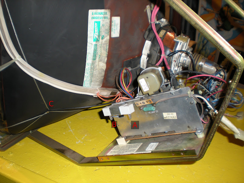

B+ is measured in DC, not AC. Set it for 200VDC.
Black lead on the frame, the other on the far end of the large white ceramic resistor bolted to the frame.
OK Great, Now I am not sure of the locations you told me, so I took a picuture and labeled the possible locations (I could be completely wrong)
OK so where do I measure A, B, C? Or somewhere else?
Between chassis ground and "B".
Can also measure at "A" and let us know what that is.
Remember, DC voltage, look for 123-130 volts on "B".
May be higher on "A", like 145-155v.

LOL OK so the frame of the monitor is not chassis ground, Got a nice HUGE spark when I touched the tester to the frame and B. OK so I will try again.
Just use the heatsink right there where everything (the resistor) is mounted.
But either way you should not have gotten a spark by metering to the frame.
there should be a green earth ground wire attached to the chassis. if I'm not mistaken, that's what links up the "ground" to the rest of the chassis when you screw it in, right? the black ground on the RGB header is just for the video signal. what do people call those... synthetic ground? lol

Voltage @ point B 152.1 V
Voltage @ point A 129.6 V
Those are off, so what do I do next? Does turning the screen knob change the value at those points?
if I'm understanding this correctly, if your B+ is running way high or too low like that, your monitor could just be stuck in HV shutdown. is it possible that's high enough that it just won't turn on? I've heard stories about the monitor at least being on for a monitor and then when a bright flash happens on the screen or 1 minute later, it'll shut off.

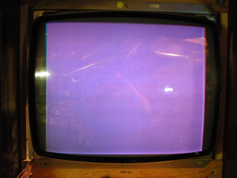

OK after taking it out and putting it back in a few more times, I seem to have neck glow now. I am even getting a picture, be it all black like before. It is almost like the RGB input is unplugged. I am uploading a video you Youtube right now. Will post when done.

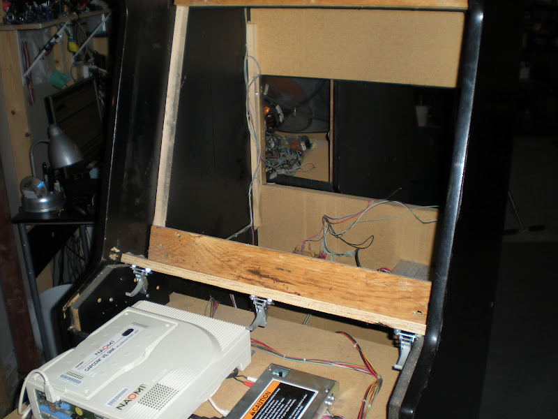

Here is the video, I just tried plugging the RGB to the monitor into my MK cabinet that is right next to it and a K7000 too. Guess what. No video. I am pulling that cabinet apart again and looking to see if anything is unplugged inside.
I am hoping that this is just a unplugged cable.

I didn't reflow the header, the solders looked fine, but I will try that, because I was thinking there was a unplugged cable, but when I backed it up and plugged the cable to the neighboring MK cab it worked (after I realized I forgot to plug in the VGA cable after doing the video.)

You might also want to try another jamma board in the cab. If the Naomi works on a VGA monitor but not in the cab it means that the I/O board might have an issue. Once that flyback craps out you're SOL. Instead of buying a whole new monitor you can drop in a Wei Ya chassis or just buy a working K7000 chassis. It would be a lot cheaper than buying another monitor.
