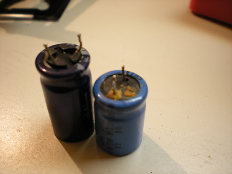

I am installing the Bob Roberts cap kit and check out just the first 2 I swapped!
Leaky!

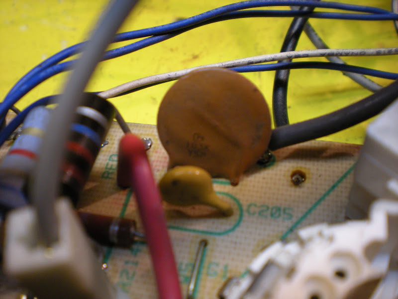

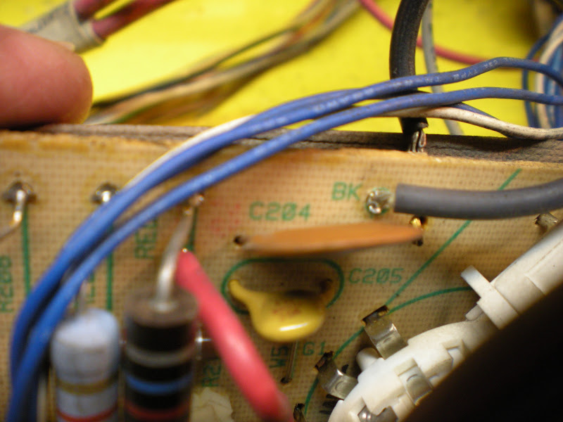

In Bob's kit there is one capacitor (C204) that is on the neck board, which I skipped because he says it is 4.7 µf 250v while the one there is .01 µf.

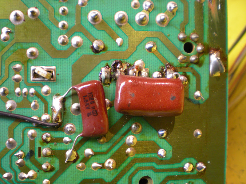

The bottom has these burned contacts I assume were done by the person who soldered them.

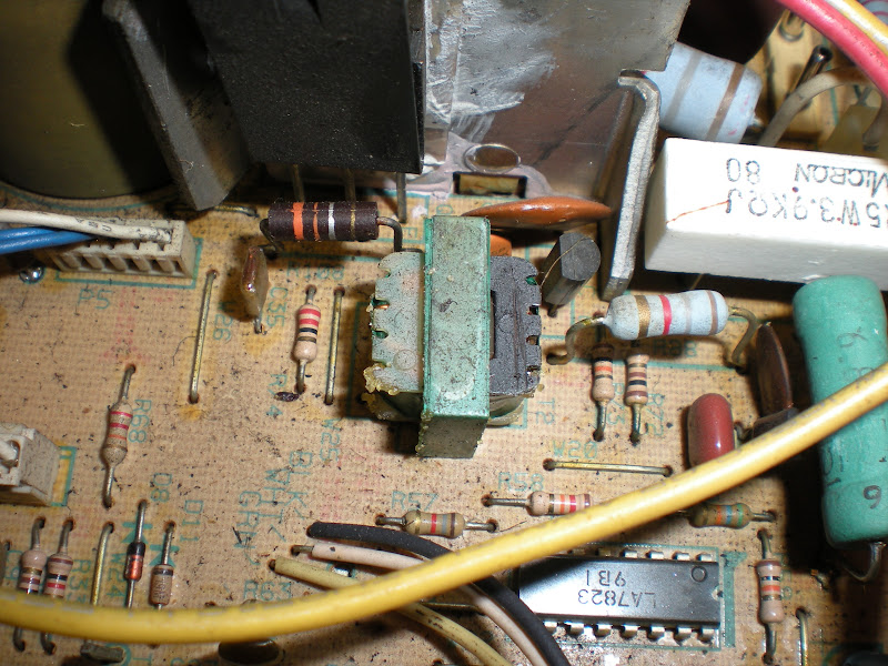

Also there is a coil on the board that is burnt and has yellow crystals on it. I blew some off with the air compressor, anyone know where I can get a replacement, and if it is worth it?

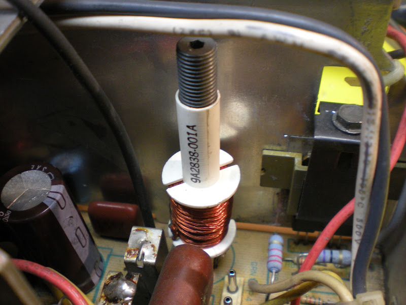

None of the things you asked about earlier are of too much concern... the plastic piece on the tube, the little transformer, the burn marks are just old flux from soldering.
That width coil should not have to be turned all the way out like that though, run it back down in until about flush with the top, that's a good starting point.

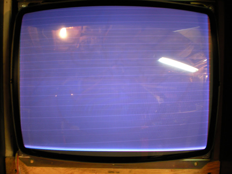

Almost looks as if you had no video input on that blueish screen, and the SCREEN voltage on the flyback may have been a tad high causing the white lines.

Did you also verify the "values" of all the caps as you changed them?

If you had retrace lines, turned the horizontal width coil, and now have nothing on the screen, then you most likely have cold solder joints in that horizontal output section either on that width coil or the power resistors and mylar capacitors nearby. This is very common. Wiggle each of those big parts while watching the solder underneath. If you see any that look to be moving, reflow the solder until they don't. See if that helps...

I also checked all the solders and they look good. I found what I think is a open between R104 and D23. The continuity tester shows continuity in both directions. Shouldn't a diode only only have continuity in one? Heck I don't know what I am doing. I am good at soldering, but I have never worked on a monitor before. All I know is that every time I take that neck board off, more plastic falls off. These Zenith monitors are real POS. I am this close to spending the $299 for a new Makvison 25". Even if I fix this shitty monitor it will break again, and by then I won't be able to buy a new monitor.

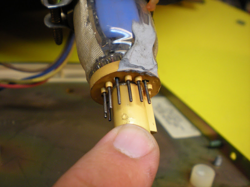

I think that the tube lost vacuum, I can hear it click 3 times and then no neck glow. I don't think I did anything wrong with the board, I think that the neck gave up after pulling it 5 times. The plastic is really brittle, and one of the pins was sticking out further than the rest.

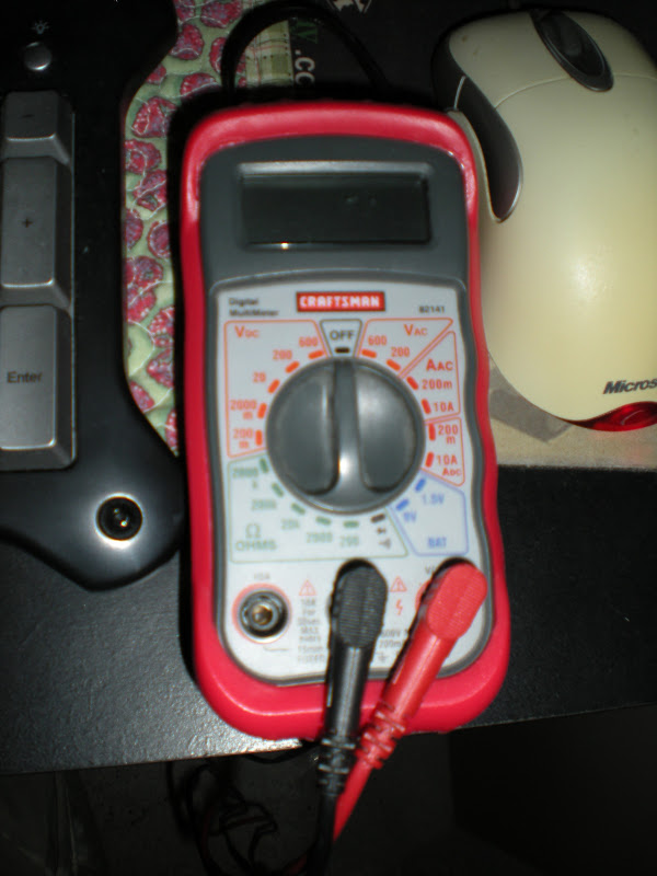

Where do I measure B+? What kind of values should I be getting? This is the only meter I have, it only has 2 VAC settings 200 VAC max and 600 VAC max.
B+ is measured in DC, not AC. Set it for 200VDC.
Black lead on the frame, the other on the far end of the large white ceramic resistor bolted to the frame.
