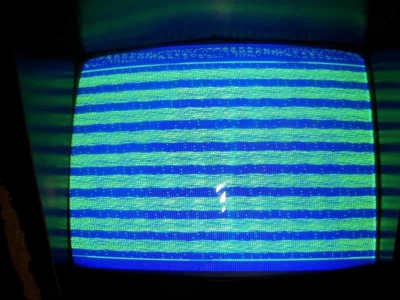

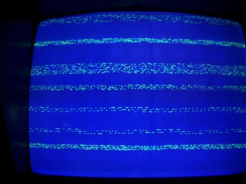

Hey everyone. Ok i did my first rebuild on my G07-CAO Monitor Chassis. I replaced the flyback, HOT, regulator, all caps from BR's cap kit. Powered up and looked great for awhile but then after 5 minutes screen went haywire.? i turned it off let it set for awhile fired up looked perfect, then went bad again after 5 minutes or so. Here's some pics any ideas??>
Oh also i tried messing with all the pots and the vertical size works fine, but the horiz hold and vertical hold dont seem to help much? plus when i turn the horiz. hold pot all the way to the left i hear a high pitched squeal sound?
ok my hunch is a loose solder joint now after discussing with a few members via pm. Im gonna pull the chassis tonight and check over everything. seems like when it heats up maybe the joints expand and loose connection possibly?

If it's happening consistently after the monitor has been on for a while, it might be something breaking down once it heats up.
Get some freeze spray (or duster spray and turn it upside-down) and spray it on the components on the board once it starts messing up. Pay attention to transistors and ICs especially. Once you hit the problematic component, the screen should clear up again, then go back once it heats up.
its doing it constantly now, everytime i turn it on now the picture is all garbled and even bending in on the sides and racing across the screen real fast, and then sometimes slow

One issue you may be having is that the horizontal oscillator may be WAY off after replacing some caps in one of the related tuned circuits. I think there is a procedure for roughly setting the Hfreq so that the horz freq control has better fine-tuning control of it.
So, get the B+ set close and then look at this.
Bear in mind that the manual wants the monitor to be warmed up before setting any of these adjustments.
