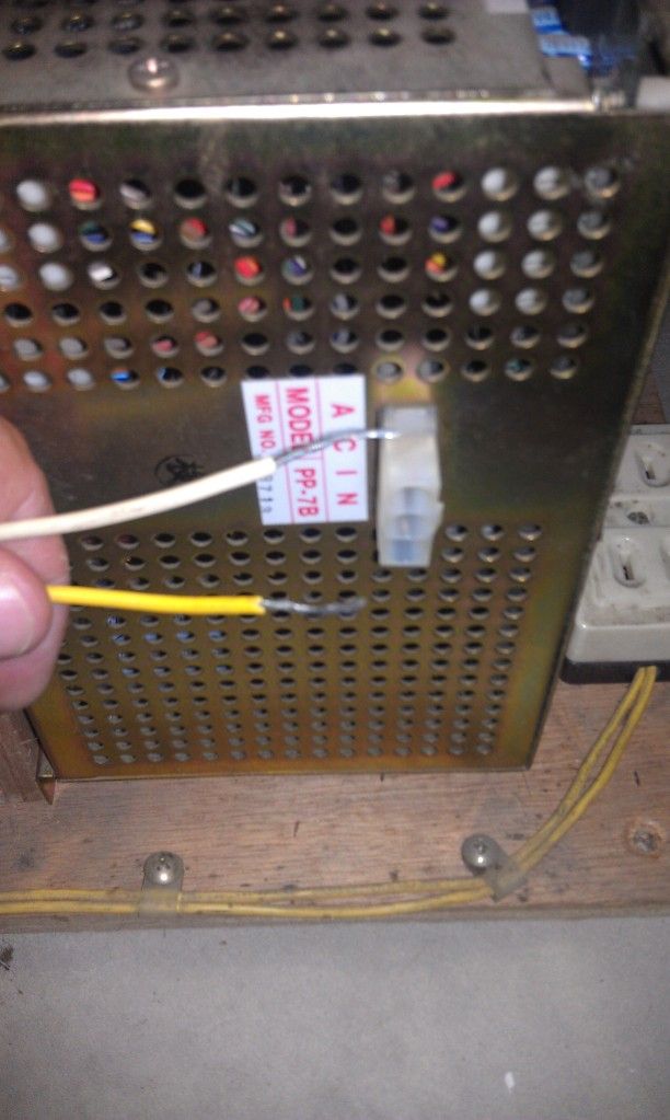

Ok guys, need help with a DK power supply...
I'm rebuilding a hacked setup... I've got a white wire, and a yellow wire that connect into the side... the 3 pinned plug only has 2 pins in it (top and bottom vertically)
Can anyone check their DK power supply and tell me if its either:
Yellow - Top
White - Bottom
or
White - Top
Yellow - Bottom
Here is a visual:
Thanks for your help!
had mine open the other day, pretty sure yellow is top, by the 'A', i can check for sure when i get home from work...if you can see inside there are yellow and white wires connected to the other side, just match them up...
