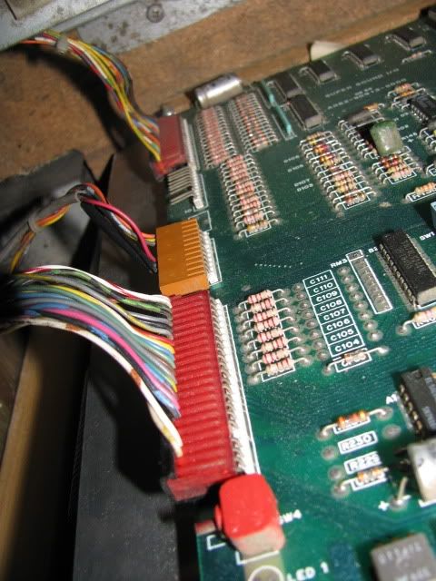

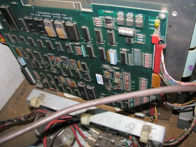

Here's the current set-up of ssio, anything appear to be amiss?
that looks right, but pull that bottom connector, and make sure there's not a pin bent down and not making contact. Fwiw, all of the buttons that aren't working are on that 19 pin connector - j4. There's only one ground that runs to them all. Its either pin 9 or pin 19, and it should be either yellow, or yellow and red. Not sure what to tell you other than that, it might be bad ribbon cables, but i kinda doubt it. I had a pcbset here last week that would do everything but steer and brake. Turned out to be a bad z80 ctc on the cpu. Don't ask me why, but replacing it fixed it.
