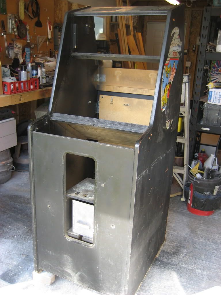

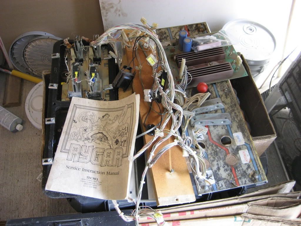

I am sure some of you remember this abortion that was on ebay a few months back. I was embarrased to say I bought it :) I've wanted a Reactor for a while and they dont come up that often, so I bid on this pig. Needless to say, I was very dissapointed when it arrived. The seller left alot out of the auction as far as im concerned. The original wiring harness was a hacked mess. I was amazed that it worked at all. The monitor was dim and shook, the bottom 2" of the cab had been cut off. There was water damage on the lower 12" and somebody took a belt sander to the whole cab and used fleckstone paint! I can deal with the paint job, I could see that in the pics. Oh, and it had saweet custom side art. The seller agreed to refund me a couple bucks to fix up the cab. Check it out....

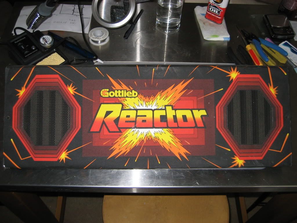

Now I didnt take many pics, I was too lazy to walk back to the house to get my camera...more than once :) Anyway, you can see how it turned out. I was able to locate all new reproduction artwork. I added a cooling fan, translucent red trackball powerd from a seperate switching power supply. I added the 2" at the bottom that was missing. I added tha 2" by using a biscuit jointer and building blocks on the bottom for the leg levelers. I was also able to modify an early production Qbert wire harness to a Reactor harness by adding & removing a few wires then repining the edge connector. I got new tinted glass and ditched the scratched up plexi. Much nicer than that crap that was in there. I also popped in a new Vision Pro. It came out really Nice...I dig the music! Fits nicely in Gottlieb Row...
