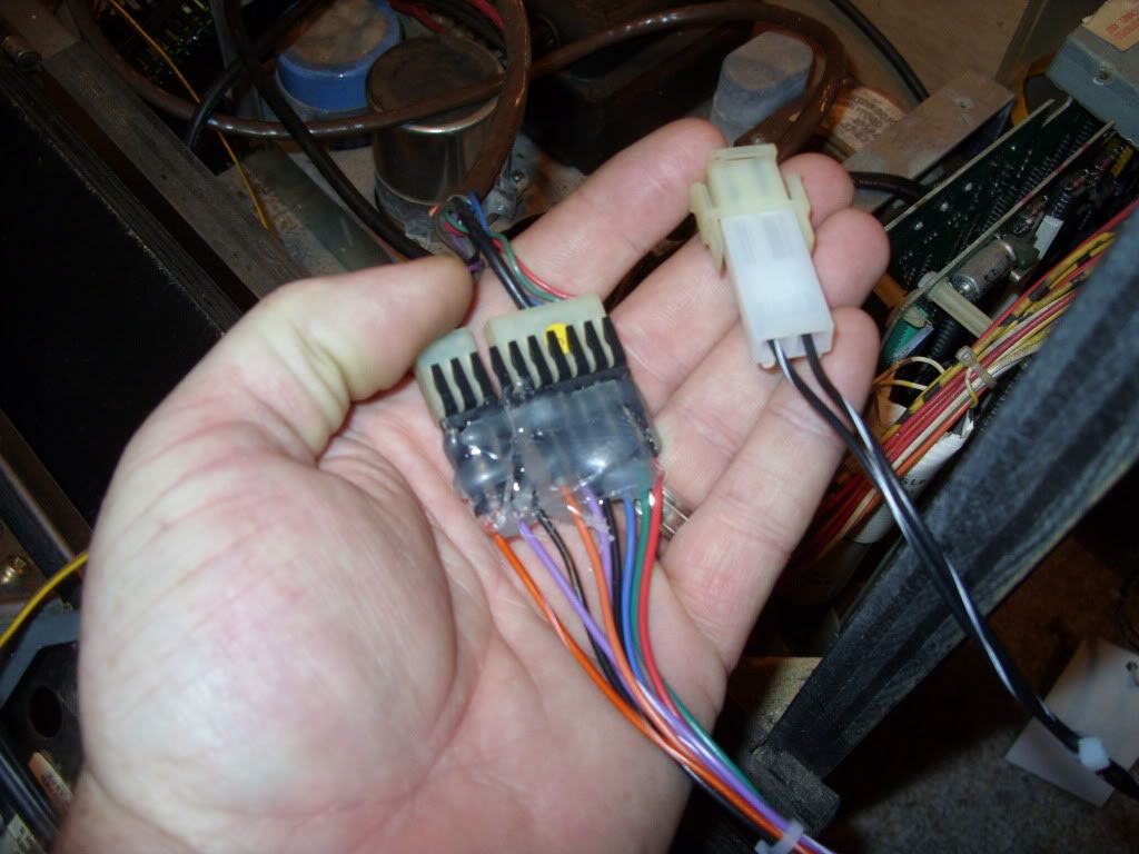

Due to numerous emails, I will be making a limited run of 20 Raster Monitor Test Aids. This is a 5 foot monitor extension harness that will allow you to test and adjust most Raster monitors with ease.
I do not have any pics for you to see at this time. Maybe one of the two Prototype owners will post some for all to see. The prototypes have been in use for a few weeks now, and tested pretty thoroughly with various different Raster monitors.

Very close to what Bob has but a little different. My take on it, was to make them as close to "dummy proof" as possible.
Mine has a 9 pin male header, with a 6 pin female connector & a 3 pin female connector. It is a straight pass through, that is almost impossible to hook up wrong. Just plug it into what you have and go to work. No need to shift any wires, no guess work, neg sync, pos sync, comp sync, doesn't matter.

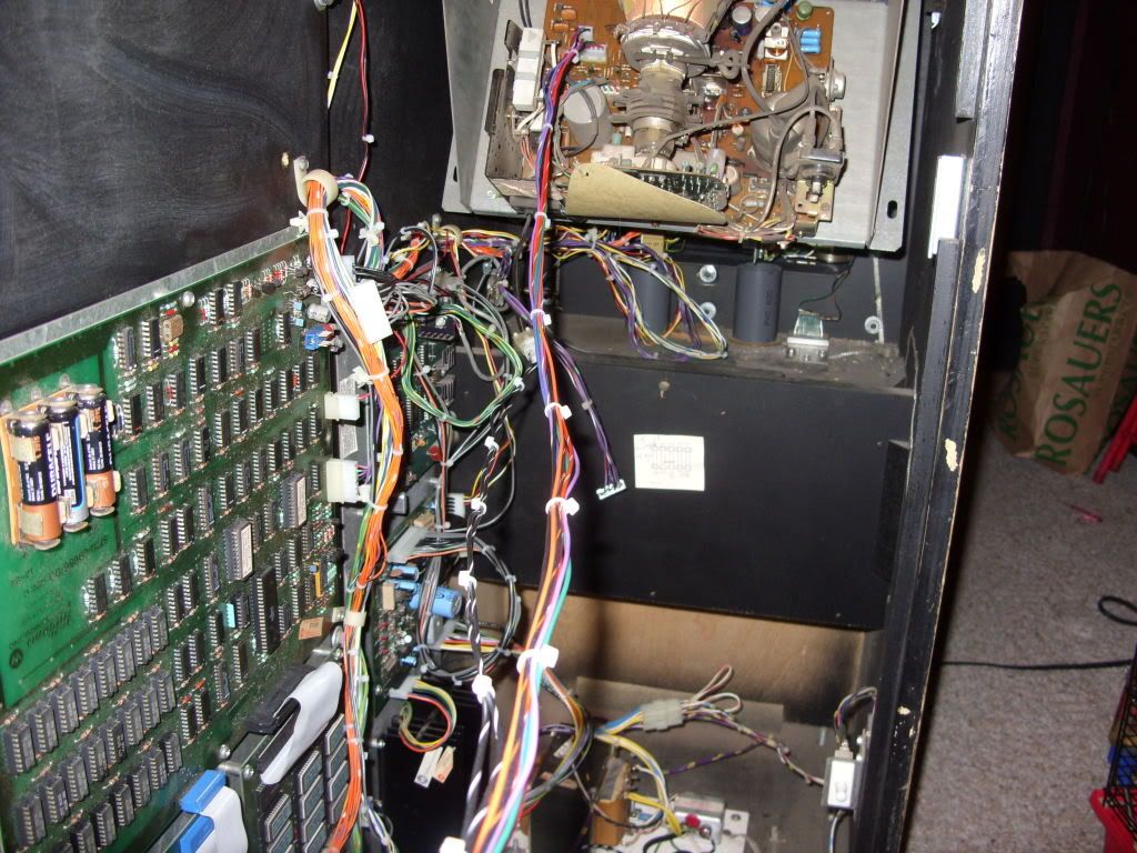

I have one of these prototypes, I cant cant tell you how many times I have had to pull monitors to test in other machines. Sometime you can back machines up real close and the cables will reach, but thats still a pain.
These extensions are so cool. 5' long make them reach with ease. I have used them on several machines in the last few months.

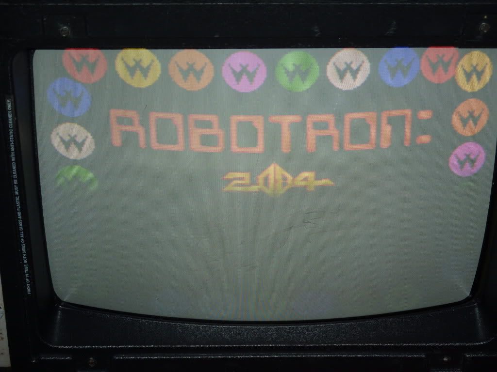

I had a Satans Hollow Ct monitor was bouncing. The seller told me to pull the chassis and mail it to him for repair. I told him I would like to test it first. Being a cocktail I could not simply back it up to another machine the connectors would have never reached. I would have had to pull another monitor and set it next to the cocktail, then pull the one in the cocktail to test in another machine.
I Hooked this extension up first from my Robotron Mini to the bouncing Satans Hollow monitor. still bounced. then I hooked up the Satans hollow to the robotron mini no bounce. It took a few seconds to hook this up instead of the time to swap monitors.
Found out later a shield was removed on the powersupply in the Satans Hollow. The transformer feedback was causing then bounce.

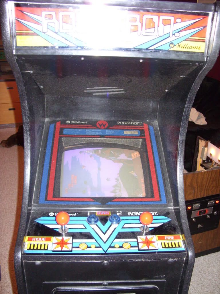

2. djw90, your Robotron mini is painted black on the inside, too. Someone had questioned why mine was; looks like they probably came that way. Kewl.

No need for a sync switch with this unit, as it is a straight pass through. Whatever you put in, is what you get at the monitor.
You can hook up the 6 pin connector and the 3 pin connector to your monitor and leave them attached to your monitor. Then whatever boardset or sync option you connect to the header will be correct at the monitor.
Yes the paint on the inside is original, from what I was told. Its a perfect match to the outside black. This is a question I asked the original seller, he said he saw 4 that were black inside too. you can also see the little paper stapled inside is original over the black paint.
