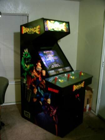

BTW - do y'all have dedicated machines or kits? Mine is dedicated:
Wow - great looking machine. I only have the PCB - not the full machine.
