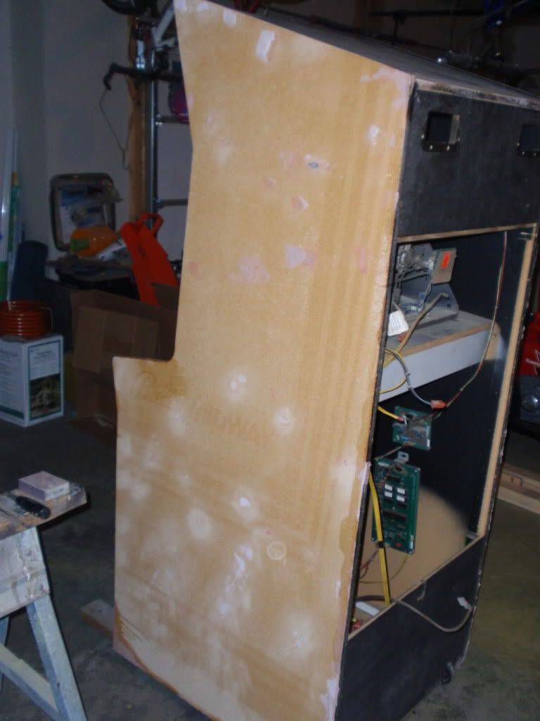

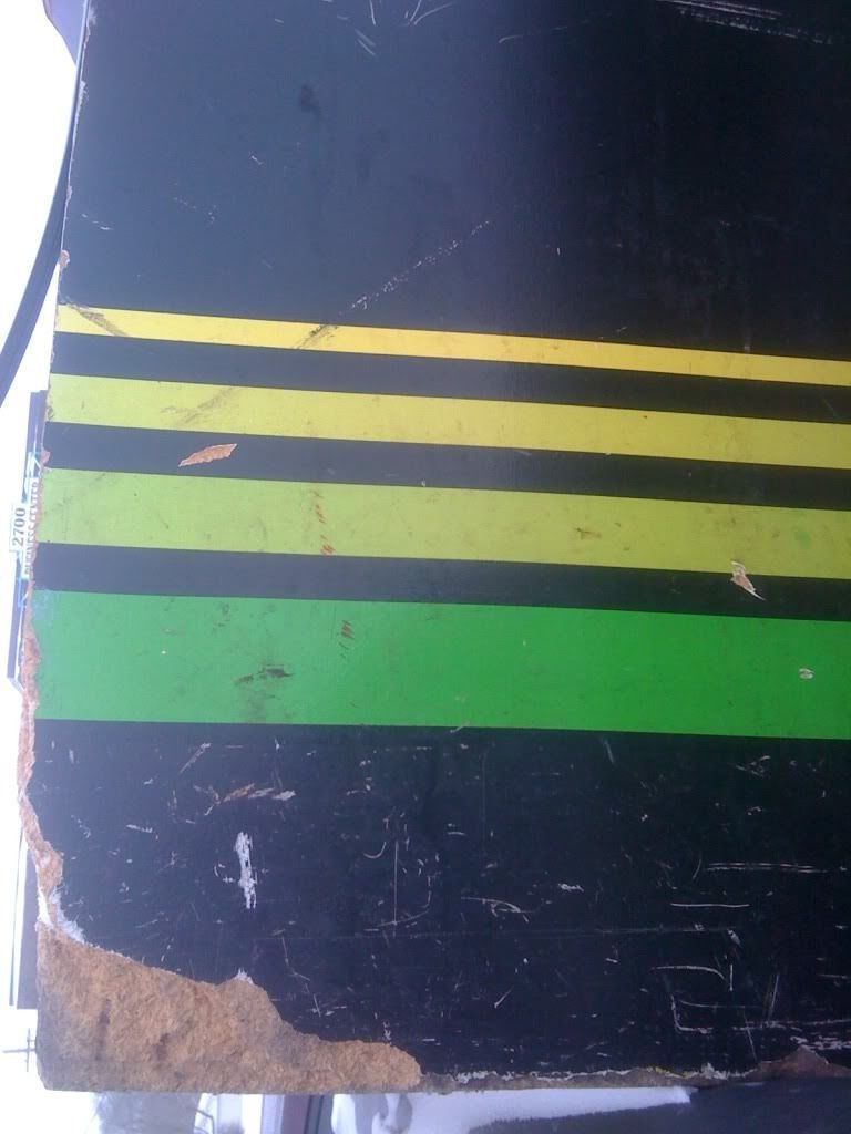

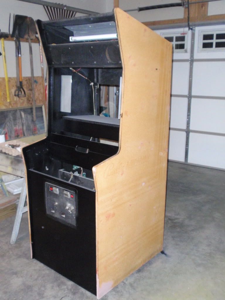

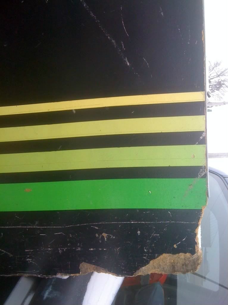

Finally making some progress on this one. I thought about trying to repair the cabinet and just saving the art, but the bottom of the machine was just too chewed up, both front corners were missing, the CP area on the cab had both corners broken and there were several dings and gouges in the middle of the side art. Did a complete removal of all vinyl and saved the artwork enough to send it to Rich for scanning, stitching and reproing. I am told that they are close to having the art work finished. As to the cabinet, I fixed the corners that were broken with glue and dowels, and used screw-reinforced bondo to replace the missing corners. As to the cab feet, 3 were present, but all of the 2.5 inch rectangular leveler plates were bent, rusty, and all around seemed too inadequate for this size of a cabinet. I decided to freshen up a set of the heavier, triangular leg leveler plates Midway used on their earlier cabs as replacements. Anyhoo, before pics:
Where she is now:
Front Corner repairs:
That looks like some nice solid repairs. This will look really nice with new sideart. I passed up on one of these many years ago and really wished I would have snagged it. A+ work as usual.
Is the dark spots at the front corners from "wood hardener"? If so, do you use the Minwax brand?

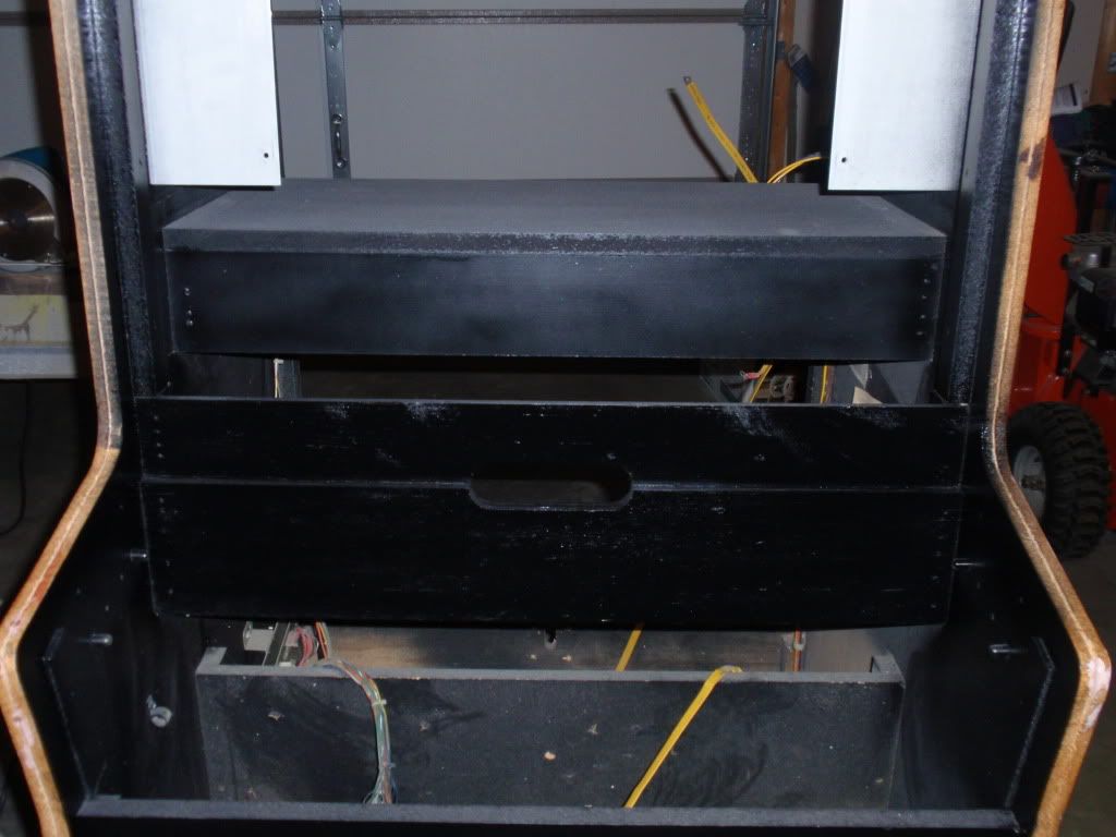

Yes and yes. I needed to stiffen up the frayed particle board, and I like to use it to make the transition from particle board to bondo stronger. It seems that you always tend to keep 'fuzzing' up the particle board edge where it meets the bondo during the many sanding sessions. I also used about 2-3 screws per corner as rebar, and there is another screw as rebar in the back edge of the cabinet, where I needed to bondo a spot that looked like a mini shark bite in a surfboard. You can kinda see it in this pic from the other side (it looks like the yellow ground wire is pointing right to the repair):

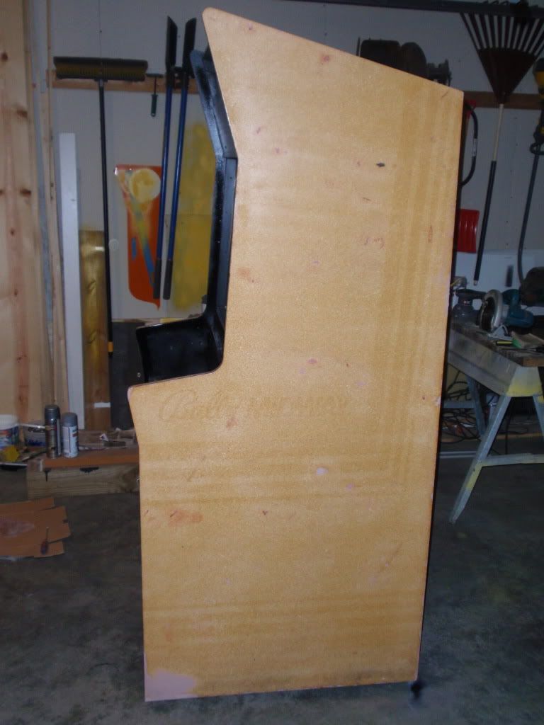

Updates. Got the bondoing finished, sanded the whole thing down with 220 and spray painted the inner edges black. Also shot 2 coats of clear coat on the sides. Getting closer to vinyling.

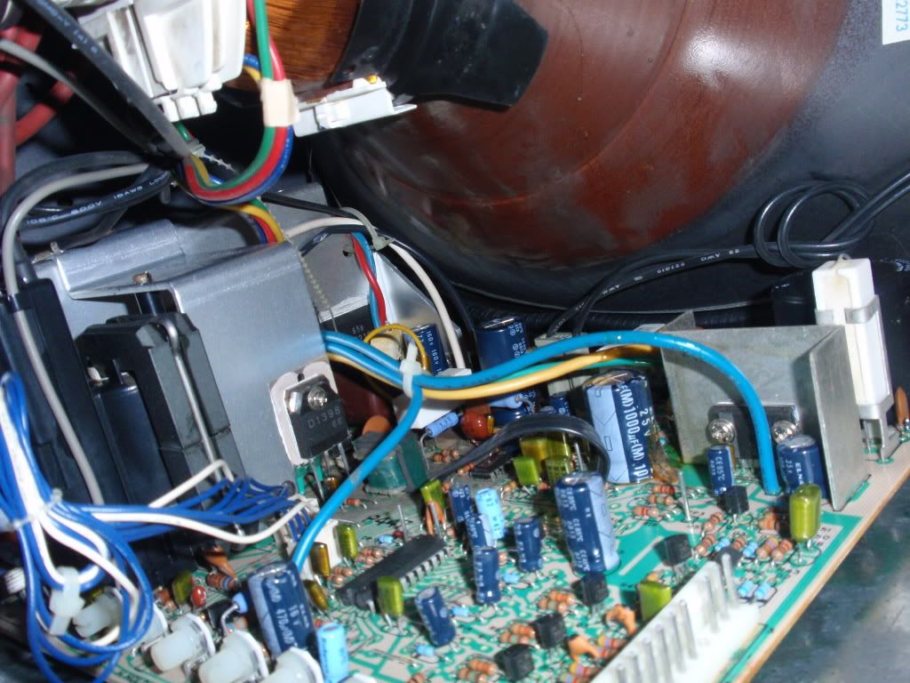

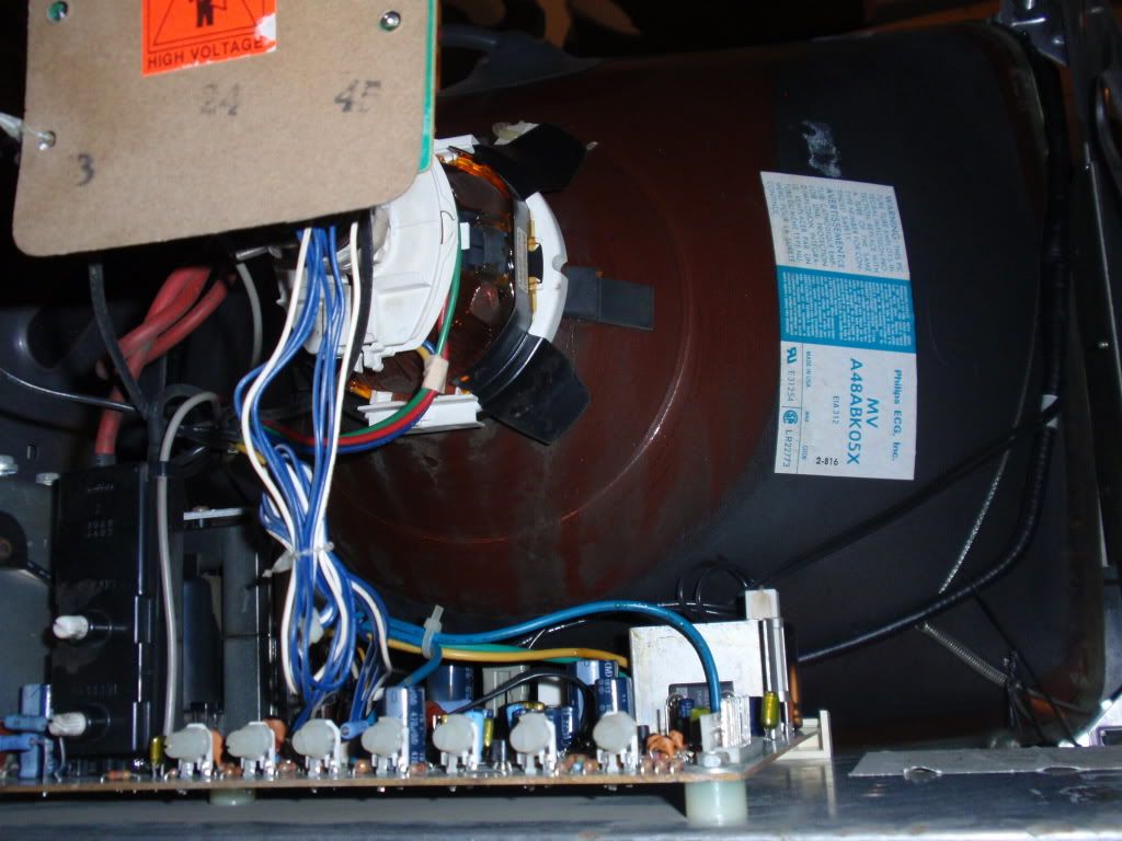

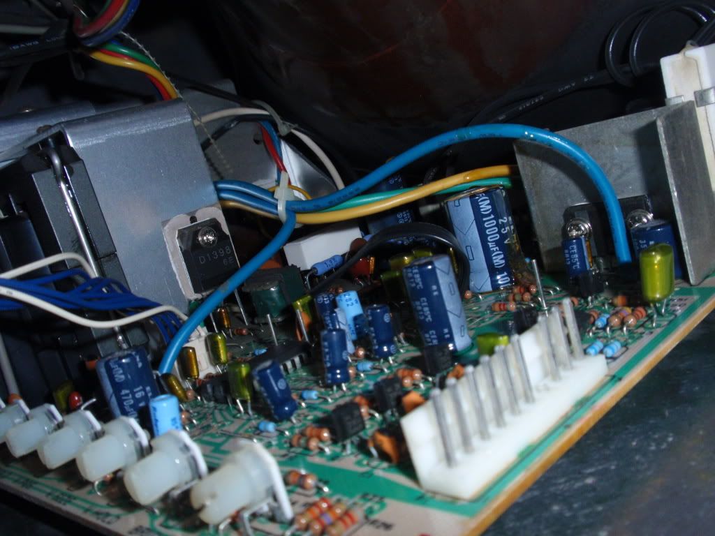

Doused the filthy monitor in Simple Green and hosed her down in the driveway. This thing looks to have been capped right thru the 1/2 inch of filth, without so much as a kleenex wipe down. What a bunch of lazy morons. It's looking much better after 2 days in front of the fan:
Now that I look closer at the pics, maybe these ARE the original caps. Man this thing was filthy. Just horrible.
I'm still so afraid to do this. I have games that are really clean inside and then you get to the monitor and... BLAH.
You just have to cover the anode hole, make sure you don't scrub too hard on the aquadog, and use an air hose and fan to dry the chassis out for a few days.
