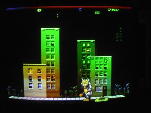

Ok well... I'm still really frustrated. Using the sync compositor board that Gibo provided the design for I was able to finally get a picture that stood still...
I tried degaussing it, but no improvement was made. The screen is still really dark/colors are really dark...
The odd thing is the very bottom and bottom left areas seem to have the colors looking fine, if not close to fine. The rest of the screen, as you can see, is all messed up color-wise. Does anyone have any ideas here on what is going wrong with this? The game plays fine, sounds fine.

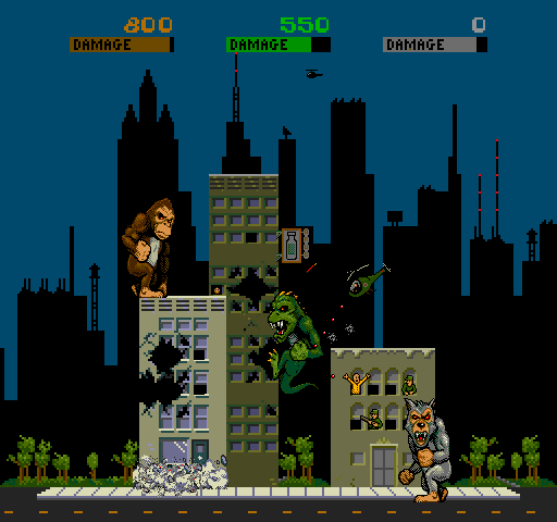

Supposed to look like this:
And yes, I've tried adjusting the pots on the monitor & the monitor remote... and the best I can get is what you see above.
Now, I've tried 3 (yes 3) different Rampage PCBs. The owner of the two I just got (from a KLOV'er) was fairly certain they were working fine. And seeing as all 3 pcbs are showing the exact same symptoms on the screen... it leads me to believe that SOMEHOW the video & sync signal from the Rampage pcbs doesn't jive with this monitor (which works fine on Dig Dug and Tetris).
And just to be sure I ran continuity tests on all the video signal wires that are OG on Rampage... they're fine, no shorts.
Does anyone have a Rampage that they can check their monitor on or if anyone has information about Rampage's video signal is out there? And/or why this monitor works fine with other games, but not with Rampage?
I've considered the possibility that all 3 Rampage boards are having the same failure, but it doesn't seem logical.
