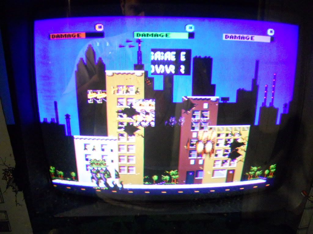

So I was moving my games around and I turned on the Rampage, and now I have a graphics issue. Double images on some of the characters. I reseated all the chips, but it didnt resolve the issue. Any ideas?
[imghttp://i242.photobucket.com/albums/ff35/descrentl/DSCN0064.jpg[/img]
That's sprite corruption. Not in front of my personal PC atm, so I wish I was more help.
You try the usual? Pull the ROM's, clean the legs and sockets, reseat. If that fails, retouch the solder connections on the ROM sockets (and board-mounted parts).
That's always a good starting point.
Edit: I see you did a reseat. Soldering time is up next, then.
Bump this.. I noticed its just moving characters that are double. So obviously a ROM issue as stated above, but anyone know which one would be causing this?
You've got something going on with an address line. The signal is either missing or the chip is broken and not using it.
Could be a bad ROM... bad socket... hard to say.
Easy way to track something like that down is to use Caesar to find which ROMs are the graphics ROMs. Look the game up in MAWS and at the very bottom of the page for it is a link to the game at Caesar. There you will find a description as to what each ROM is for - main cpu, graphics, sound cpu, etc...
Once you find that start looking at the ROMs. Do they have bent/broken pins? Are they corroded or crusted up? Do the sockets look corroded or crusted up? Do the ROMs have the right checksum? (Do you have an EPROM programmer to check them?) Are there any bad/broken/gouged/corroded traces?

I reflowed each of the 4 ROMS that handle foreground graphics, and it didnt help. I was just going to burn new roms, but Im having trouble finding the chip type. In the manual, it doesnt seem to say. I do see P28S600 on the chip, but have no clue what that is. The 4 chips are 4E,5E,6E, and 8E. I think they are 27256's but not 100% sure.
Caesar says BG-0 & BG-1 are graphics ROMs... The size of 16384 gets multiplied by 8 to get the size in bits... Those are 128K ROMs (27128/27C128)
FG-0 through FG-3 are graphics ROMs listed as 65536 in the MAME dumps so that size gets multiplied by 8 and you have a 512K ROM. (27512/27C512)
RJ

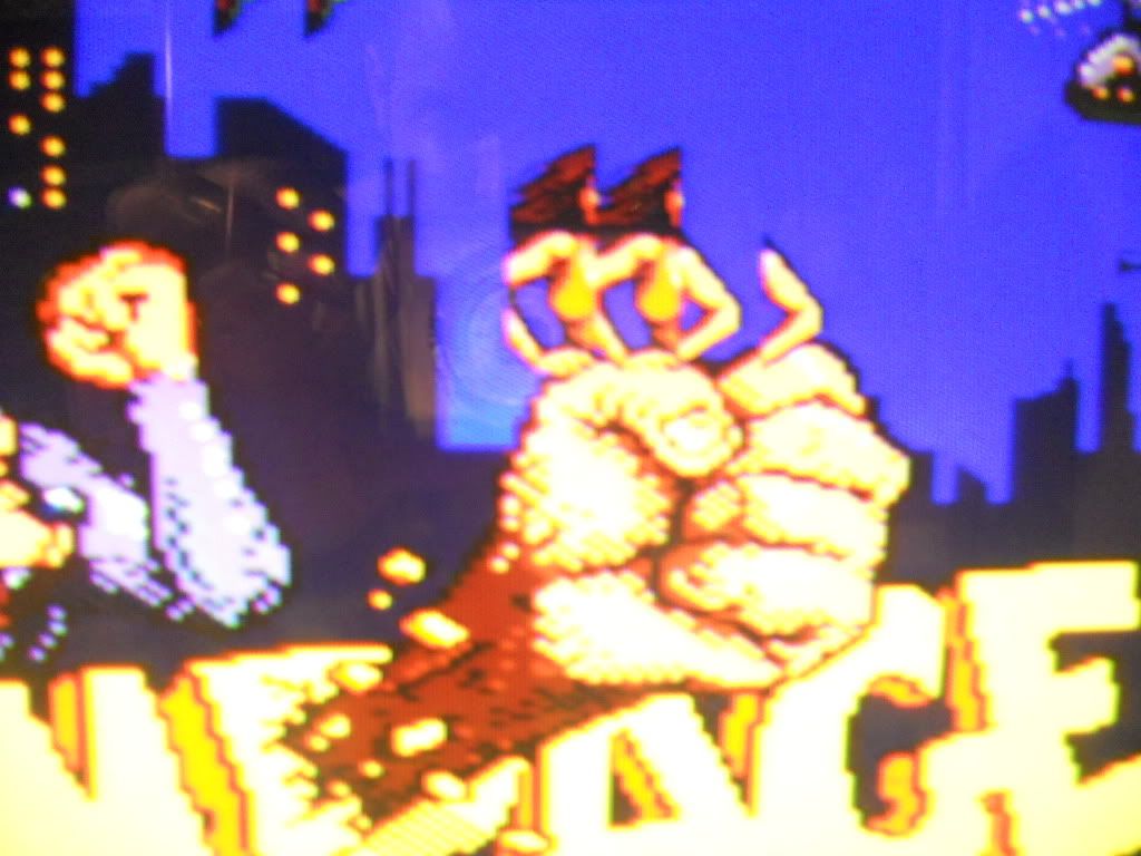

I am bumping this old thread since I don't see another one on this topic. Anyway, I am having some corruption issues myself. See this video: https://www.youtube.com/watch?v=JOCX0OTKpzw&feature=youtu.be
I re-seated the ROMS and cleaned the sockets. I don't have an easy way to check the ROM checksums. Naturally I would love to have someone close by in MA that has a board to compare with.
Thoughts?
