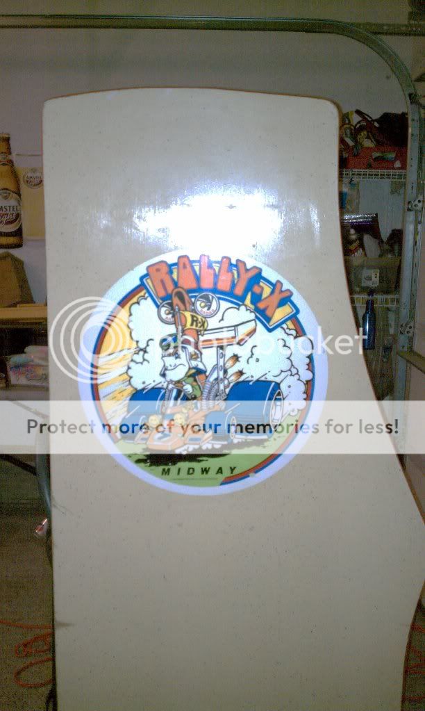

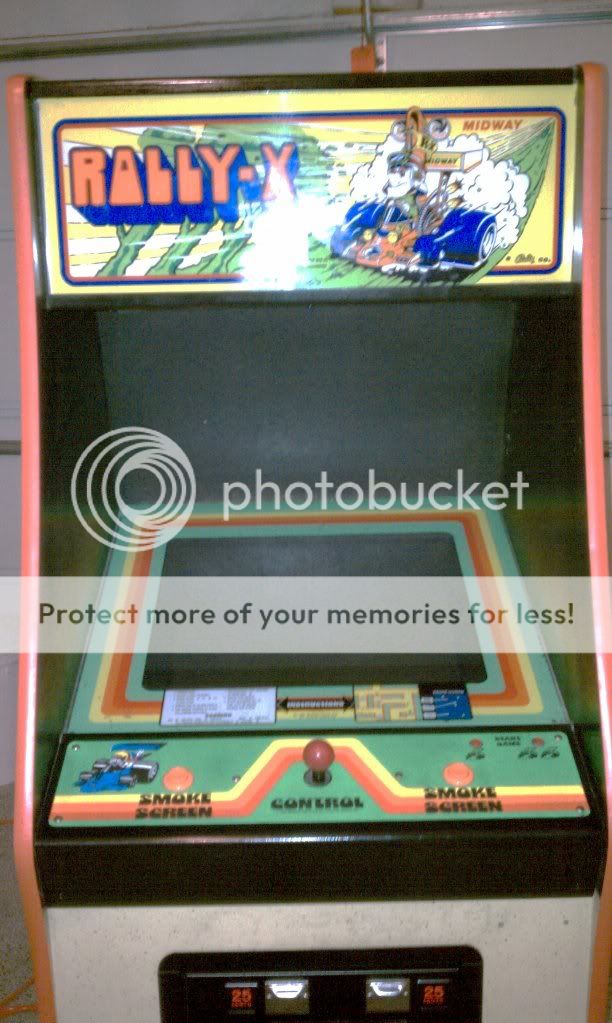

I am landing a nice rally X tomorrow. Probably a 9+ condition.
I am considering what to do with it. Its in an original midway style cab. Does anyone know if the monitor will turn?
It's probably the nicest example of the game I've ever seen... I am questioning whether or not I can convert it... bad Karma
Anyone ever change one over to 60-in 1?

its a keeper PICS up.
I am not crazy about the game, but the game is in awesome condition. The side art is simply and cool. It really wasn't a forgone conclusion. I didn't know that the game was rare. It was at 2 different places in Burlington Iowa when I was a kid. I will add it to the heard my kids enjoyed playing it. When the game board craps out I might convert it then.
