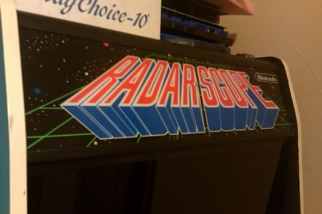

So big thanks to Ataritoobin for selling me his Radar Scope marquee and bezel they arrived beautifully, in stated condition and packed SUPER well - thank you man! Ever since I saw a few restores including a cockpit, I've fallen in love with the art, the story behind the game, and the game itself. (only through emulation though)
So anyways, I'm working on restoring a DK cab that has DKjr in it, and this stuff will probably end up going into - I am on the lookout for the PCB and control panel. Might even need to get a new power supply for the older board? It might just end up being Donkey Kong with radarscope art - who knows. I have the marquee sitting in my only operable Nintendo cab at the moment - I REALLY enjoy the this artwork and I think it's going to look great in my red cab project when it's finished.
